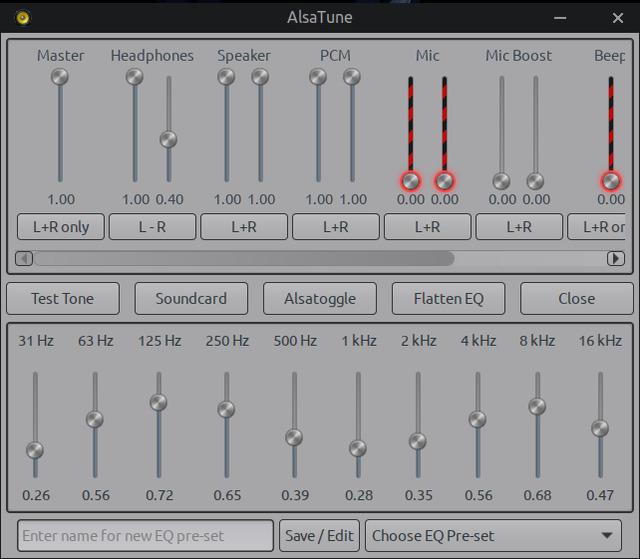

I'm still thinking about that idea we talked about months ago, building a minimal iso dedicated to audio production, tightly integrated with jack-bridge, using a DAW (and which one to use I would need to heavily lean on your recommendation), something light and fast that you could easily just run from a stick but shined in a desktop, just plug in your instrument or mic and start working.
Gratuitous screenie of today's work in progress:

Just a suggestion . . . Are you aware that the gray on gray is borderline to being an accessibility hindrance for a lot of folks? It also looks like there might be some blue there but the contrast is so minimal I can't really discern it.

golinux. I don't think the colours are hard coded, it depends on your desktop environment. For example if you install AlsaTune on xfce it doesn't look like that, it has a light background with blue sliders.
I'm a little confused as to why you would assume I hard-coded colors into my apps when i've been very outspoken about my dislike for CSD, and have in fact been active in the various efforts to defeat it and force apps to use the user's chosen theme. Vuu-do itself comes with a package that overrides QT themes and uses the user's gtk theme instead. And i've dumped all the gnome apps that force CSD on people with gtk4 and libhandy.
But it's an important point so thanks for that, let me address it here as I don't think i've ever mentioned it:
Yes that's my theme, it's gray and mild and easy on the eyes and not at all difficult in person to discern the differences, and a monochromatic look for a utility is fine, AT is a tool, not a toy, so it doesn't need a pretty party dress.
The only color that's coded in is the red/black striped sliders and glowy button for a muted channel, because I needed something that would stand out clearly in both light and dark themes. Everything else, colors and fonts etc. are all 100% users theme.
Speaking of visual hindrances, I reported this months ago, but it's still the default theme when you choose the Mate desktop:
