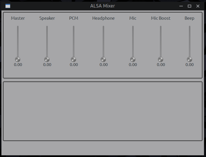

Posts: 1,545
Re: ALSA-only purists: Question, new GUI app for the mixer and EQ?
Thanks for the thoughts y'all! So here's a very rough prototype, got the logic worked out for the mixer that's in the top tab and it's working great, and have an empty bottom pane where the EQ will go, but it's gonna take more work on the EQ than it did the mixer. Plus there will be some stuff at the very bottom, info about sound cards and chips and some other things.
Screenie of progress so far:
#7 2025-07-03 17:29:10
Posts: 289
It looks nice. Which toolkit are you using?
#8 2025-07-03 17:37:02
Posts: 1,545
^^^ Hi aitor! Using GTK and some CSS in a C script. Been working all morning on the EQ section, have probably modded/re-compiled/tested the script about 60-70 times already and no luck yet, it's a lot harder than it was getting the mixer section to work.
