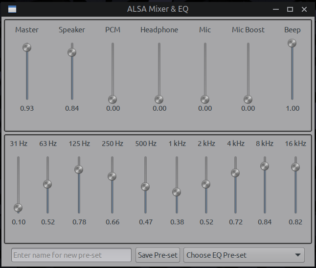

Thanks for the thoughts y'all! So here's a very rough prototype, got the logic worked out for the mixer that's in the top tab and it's working great, and have an empty bottom pane where the EQ will go, but it's gonna take more work on the EQ than it did the mixer. Plus there will be some stuff at the very bottom, info about sound cards and chips and some other things.
Screenie of progress so far:
#7 2025-07-03 17:29:10
Posts: 308
Re: ALSA-only purists: Question, new GUI app for the mixer and EQ?
It looks nice. Which toolkit are you using?

^^^ Hi aitor! Using GTK and some CSS in a C script. Been working all morning on the EQ section, have probably modded/re-compiled/tested the script about 60-70 times already and no luck yet, it's a lot harder than it was getting the mixer section to work.
#9 2025-07-03 21:48:15
Posts: 1,656
Wow, that part was crazy hard, i've been at it for like 7 hours today, just for a tiny bit of stuff it seems like, lol, but part two is done and the whole thing is now 100% functional, sitting here using it right now listening to Boot Liquor playing through Exaile. Last parts should be super easy by comparison. Working draft:

Part 3: Pre-defined and user-defined pre-sets for the equalizer?     fsmithred ducks
