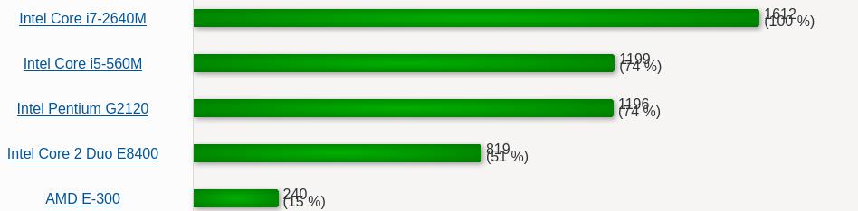

Re: all the new kernel disturb some old PC's!
Not quite on topic, for clarity, You can compare processors.
https://www.chaynikam.info/en/cpu_compa … N4000`135`

Downloadable 32 vs 64, a few years ago I just looked at the test numbers in the hardinfo program, 64 is faster.
