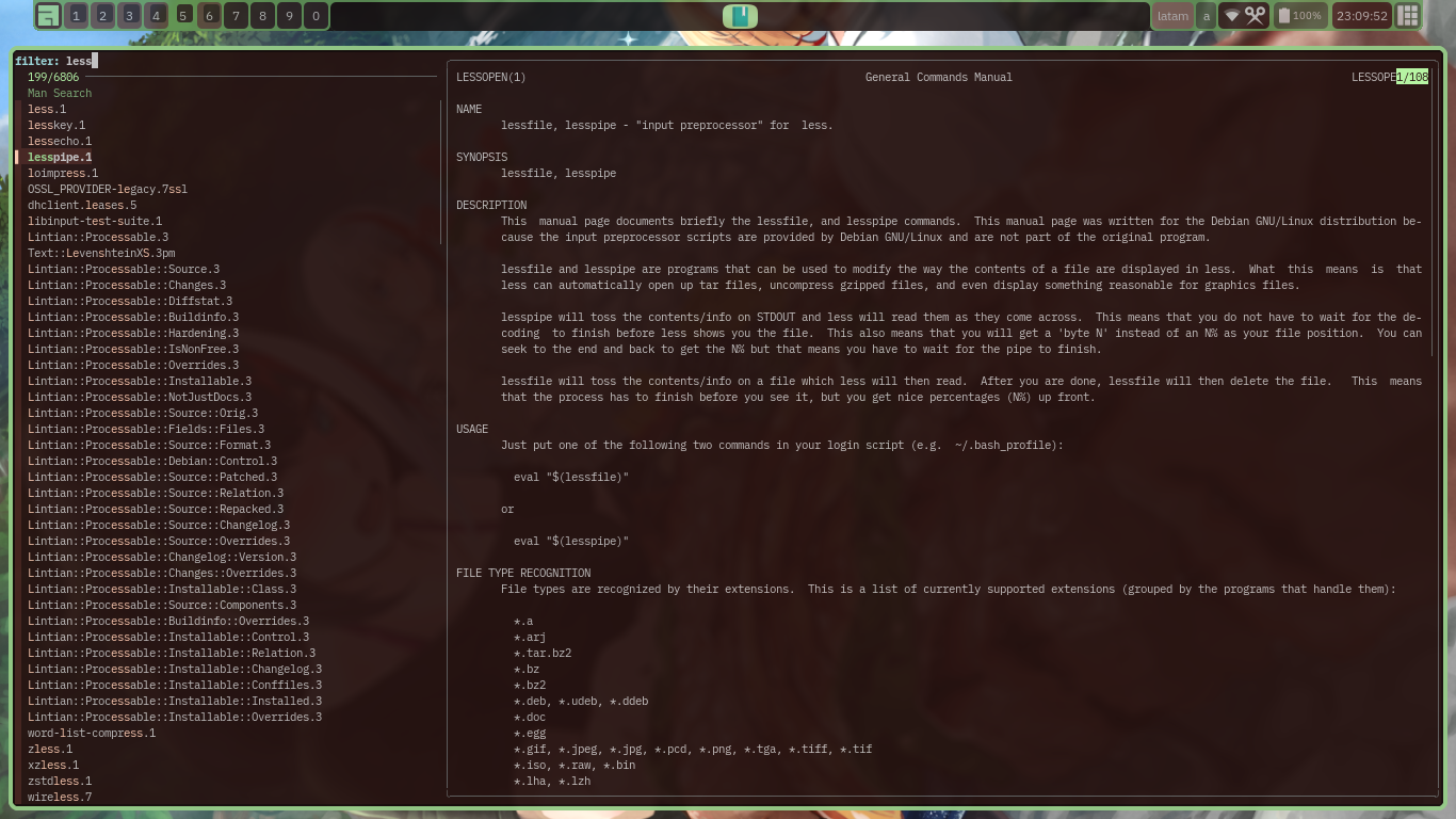

something that definitely helps for streamlining the usage of manpages is the capability to fuzzy search manpages with in search previews of the manpage, that way you can read some of what information it has before opening it with man proper
and as it turns out i happpen to have a script for that leveraging fzf
https://github.com/eylles/mansearch
could probably write a manpage for it, put out a release tag and maybe look to package it for debian if there's any interest
