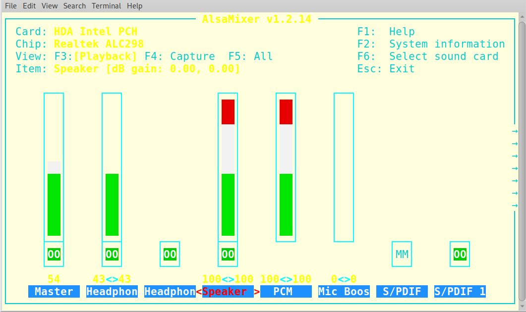

You've probably already done this, but on my laptop when you open the alsamixer, there is a "main" volume control, and there is also a "speaker" volume control which is the laptop speaker volume specifically. If both are not at 100% then I won't get full volume on my machine.

For me, it was enough to increase the speaker volume. The alsamixer command

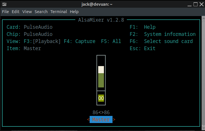

^^Good simple solution! The problem starts when a mixer gets involved, here's what alsamixer looks like in a system with pulseaudio:
Yeah, ol' retard pottyring doesn't think you need access to such things.
Then there's AlsaTune, which has a completely different philosophy:
