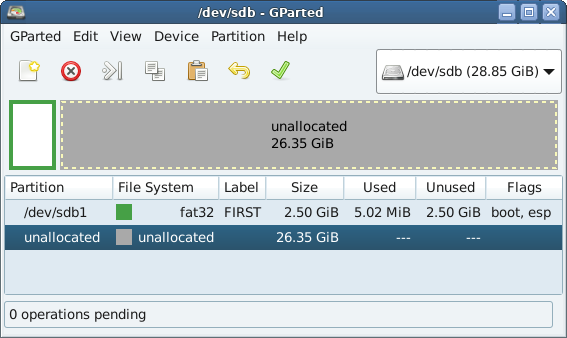

After dd if=/dev/zero of=/dev/sdX bs=512 count=4096 I run gparted
created a partition table type gpt
then when I choose ISO_2 (to try) in the GUI I got
The boot flag is not set on /dev/sdb1
Thanks.

You need to make the first partition big enough to hold the iso (packed or unpacked) plus kernel and initramfs. If you plan on adding more than one iso to the stick, then make it big enough to hold all the isos. ISO_1 or ISO_2 will work. One unpacks the iso file and the other one keeps it intact and uses the 'fromiso=' boot option. That option is useful if you think you want to have a copy of the intact iso to use it somewhere else or share it.
If you think you might want to use the stick to share files with windows computers, make the first partition big enough to hold those files, too.
Yes, you need to give the fat32 partition the boot flag. You can do that in gparted.

@SpongeBOB: Why not try msdos partition table?
R2u uses syslinux/isolinux,  it's more complex to get that working for gpt (and you don't need gpt)..

Gparted: create new ms-dos partition table. Create fat32 main partition big enough to hold iso with some room to spare. Create 2nd partition in ext2 and name it "persistence. Then add boot flag to the first partition. done.
R2USB: use 01 or 02 first, I use 02 with the "findiso" option, finish that operation. It will want to install syslinux, let it do so. When done it will take you back to menu, then choose the option to create the persistence partition, run that, when it's done you are done, exit program.
