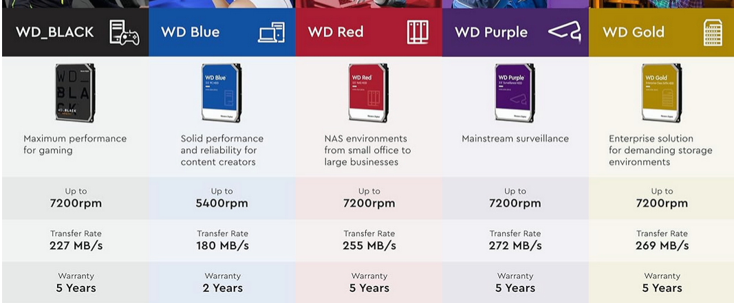

#10 2024-03-15 03:03:49
Re: Reliability of desktop vs enterprise drives
Sure would like to know what the "Gold" designation means in the WD product line though.
You haven't scrolled through Amazon a bit
https://www.amazon.com/stores/page/5189 … f_=ast_bln
And the reliability of a hard drive directly depends on its cooling. I still have an ancient Samsung from that unsuccessful series that burned like candles. I just put a fan under it right away.
P.S. If you need details, you need to look at the specs on the WD website.
For example
https://documents.westerndigital.com/co … pc-hdd.pdf
In particular, for example, operating noise.
Blue
Acoustics
Idle 23 dBA
Seek 25 dBA
Gold
Acoustics (average)
Idle Mode          20 dBA
Seek Mode          32 dBA

The data sheets I have found show the enterprise drives as only marginally louder than the consumer drives of the same size. The larger any of them get, the louder. I guess that's a predictable consequence of more platters spinning at high speed.
It looks to me that the only issue I need to think about now is whether those 'cheap' enterprise drives on Amazon are very old OEM stock, manufactured further back than their warranty technically extends. Though I've seen the warranty on the consumer drives updated when you enter the purchase date on the registration site. Maybe WD is very confident of the shelf-life of their drives? If I get a five year warranty, how much does it matter when the drive was manufactured, I wonder?
The WD Caviar Black drives larger than 1TB dropped error correction capabilities. The WD Gold drives have that and are therefore more suitable for RAID. The Gold drives a couple years ago only had a 3yr. warranty. I'm not sure about the newer ones.
The 1T Caviar Black drives I had all lasted longer than five years. (always on)
