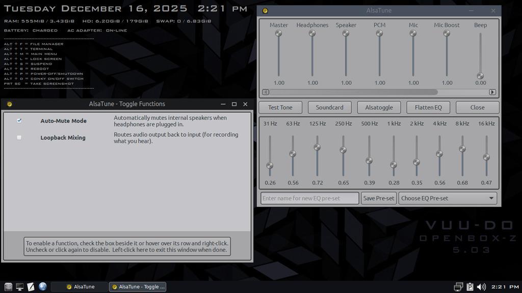

So yeah, it compiles and runs on i386 architecture. I didn't make a package. I just copied files into place and ran the postinstall script. At first the equalizer wasn't working. Then I read the README and then I googled to find 'alsamixer -D equal' which did work. After that, the AlsaTune equalizer worked.
It nice to have the volume and frequency sliders all available in the same window. Let's talk about packaging in real time.

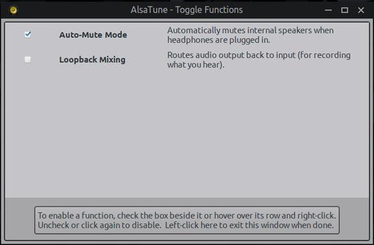

Got it all essentially done, I added one more feature after adding the new button/script, I added a tooltip that only appears when you hover over volume sliders that have a mute function, to let you know that you can right-click to mute/unmute, it's a small thing but there was no clear instruction about that in the main gui.
So for the new script, it would be so amazing if some of you smart folks could take a minute and test function. It's a complete standalone script so you don't need AlsaTune to run it, just compile it and run. I'm especially interested in any new toggles it might miss, and whether it gives a proper description on common toggles or falls back to the default because of a new name.
You will need gcc of course and all that it pulls in, and you will also need the libgtk3-dev and libasound2-dev packages.
Compile:
gcc alsatoggle.c -o alsatoggle $(pkg-config --cflags --libs gtk+-3.0) -lasound
alsatoggle.c

        GtkTreeViewColumn *col_desc = gtk_tree_view_column_new_with_attributes("Description", rend_desc, "text", 2, NULL);
        gtk_tree_view_column_set_expand(col_desc, TRUE);
        gtk_tree_view_append_column(GTK_TREE_VIEW(treeview), col_desc);
        // ListStore: active (bool), name (string), description (string)
        data.store = gtk_list_store_new(3, G_TYPE_BOOLEAN, G_TYPE_STRING, G_TYPE_STRING);
        gtk_tree_view_set_model(GTK_TREE_VIEW(treeview), GTK_TREE_MODEL(data.store));
        for (int i = 0; i < data.num_channels; i++) {
            snd_mixer_elem_t *elem = data.channels[i].elem;
            const char *name = snd_mixer_selem_get_name(elem);
            const char *desc = get_description(name);
            // Determine current state
            gboolean active = FALSE;
            if (snd_mixer_selem_has_playback_switch(elem)) {
                int val;
                snd_mixer_selem_get_playback_switch(elem, SND_MIXER_SCHN_FRONT_LEFT, &val);
                active = val;
            } else if (snd_mixer_selem_is_enumerated(elem)) {
                unsigned int item;
                snd_mixer_selem_get_enum_item(elem, 0, &item);
                active = (item == 1);  // Adjust if any are reversed
            GtkTreeIter iter;
            gtk_list_store_append(data.store, &iter);
            gtk_list_store_set(data.store, &iter,
                               0, active,
                               1, name,
                               2, desc,
                               -1);
        g_signal_connect(rend_toggle, "toggled", G_CALLBACK(on_toggle_changed), &data);
        g_signal_connect(treeview, "button-press-event", G_CALLBACK(on_row_click), &data);
    // Big goofy close button at bottom
    GtkWidget *close_btn = gtk_button_new_with_label("To enable a function, check the box beside it or hover over its row and right-click."
    "\nUncheck or click again to disable.  Left-click here to exit this window when done.");
    gtk_widget_set_tooltip_text(close_btn,
    "Click this button (or the window's X) to close when you're done. "
    "All changes are applied instantly and saved on the backend, no further action needed.");
    gtk_widget_set_halign(close_btn, GTK_ALIGN_CENTER);
    gtk_widget_set_margin_top(close_btn, 10);
    gtk_widget_set_margin_bottom(close_btn, 10);
    g_signal_connect_swapped(close_btn, "clicked", G_CALLBACK(gtk_widget_destroy), window);
    gtk_box_pack_start(GTK_BOX(vbox), close_btn, FALSE, FALSE, 0);
    gtk_widget_show_all(window);
    gtk_main();
    cleanup_alsa(&data);
    return 0;
https://sourceforge.net/projects/vuu-do/ New Vuu-do isos uploaded October 2025!

#84 2025-12-16 12:00:55
Posts: 2,786
Re: ALSA-only purists: Question, new GUI app for the mixer and EQ?
Alsatoggle works. While watching the changes in alsamixer, it occured to me that there needs to be a way to un-mute channels in AlsaTune. If a channel is muted, the slider won't do anything and there's no way to know that without opening alsamixer. (or did I miss something?)
Oh yeah, I did this in i386. BTW, when I try to run the 32-bit program in a 64-bit system, I get an error message that says 'file not found' but it doesn't tell me what file it's looking for. I don't know strace well, so maybe someone can tell me what options to add to get better output. Here's what I got:

#85 2025-12-16 15:09:57
Posts: 1,367
You did. Right-click any one of the sliders themselves in AlsaTune. wink You know it's muted if the slider turns red/black striped. Check the screenie on page 3 towards the bottom.
I mentioned this in my last post, in the 2.1 version muting/unmuting is enabled via right-click on the sliders themselves.
But I never made it clear in the gui itself that you could do that, my bad, so I added a tooltip just for the sliders that have a  mute function in version 3 that i'm working on, that let's you know you can right-click to mute.
Really appreciate you testing!!! It's hard with just a couple machines and those all being old,low spec, and basically all the same lol. I'm sure there's more tweaks to be done in the future. But after a couple long days working the new version i'm really happy with the progress.

#88 2025-12-16 18:16:34
fanderal
Registered: 2017-01-14
Posts: 109
Had alsamixer and alsamixer -D equal in the menu but replaced both with your app... polished, easy to use and presets. Thanks greenjeans!
#89 2025-12-16 18:48:16
wert
Registered: 2025-10-30
Posts: 11

#92 Yesterday 00:41:06
Posts: 1,367
You can click the below thumbnail to get the fullsize version:
