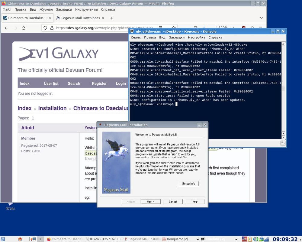

I'll post a screenshot for clarity. This is Daedalus, wine with default settings, everything works on behalf of the user. I think you need to delete the /home/xxx/.wine folder with the old garbage.
When you start wine again, it will create a new one, with all the new changes (replacing su with su-, for example).

... need to delete the /home/xxx/.wine folder ...
When you start wine again, it will create a new one, with all the new changes ...
Indeed, I had thought of doing exactly that.
But it was the last option I was considering.
I recall having to do that quite a few times in the many years I ran PMail in an MS environment ie: W98/W2000/XPSP3.
It was the go-to method ie: }à la Windows to which I had no other option when things went south.  8^D
The main drawback to that was that you never found out what went wrong and/or how to avoid it.
I'll keep it in the bucket for the time being, so to speak.
The fact that I can run PMail as root tells me that Wine is working properly and that the DLLs are all there.
The problem apparently resides in Wine not seeing/being aware of them when started as a user which is odd, to say the least because Wine must never be run as root as it does not sandbox anyhting.
ie: you are giving MS executables full access to your system and everything attached to it.
Thank you very much for your input.
And taking the time to post the screenshots.
