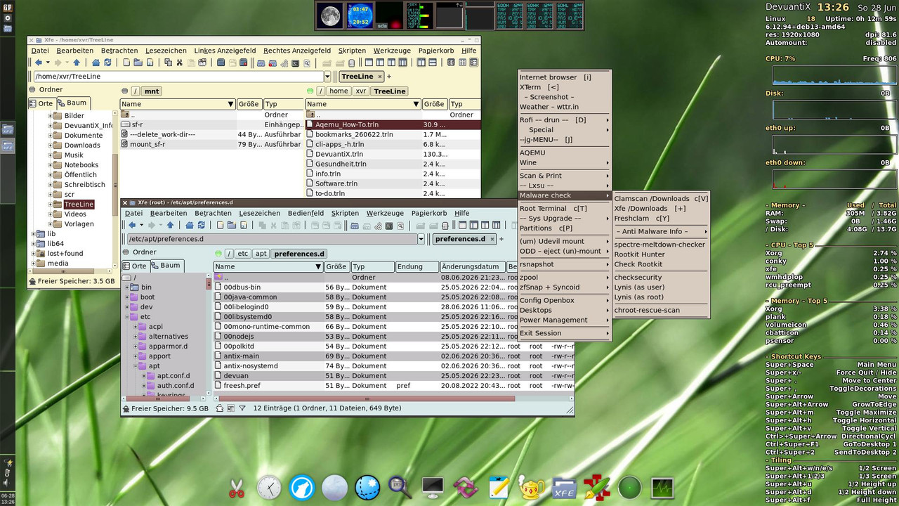

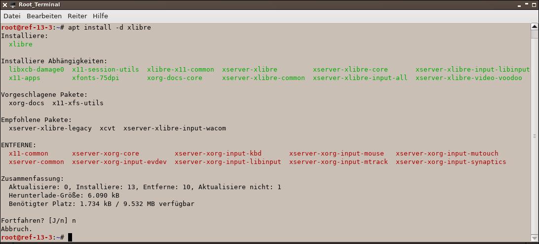

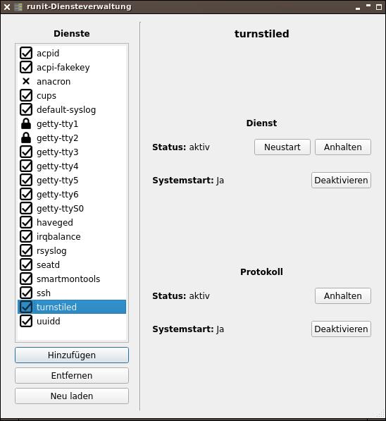

#9 2026-06-28 15:36:34
Xaver
Registered: 2025-12-28
Posts: 12
Re: Test ISO: refracta freia xlibre turnstile pipewire
Based on 'refracta_13.3_nox_amd64-20260501_1521.iso' I have created a similar system in qemu.
Already two years ago I had build such a system based on antiX-23 (bookworm). It is running stable on my desktop pc as my work horse.
These have been my steps:
(1) install refracta_13.3_nox with runit and seatd
(2) exclude unwanted packages via pins in /etc/apt/preferences.d:
00dbus-bin 00java-common 00libelogind0 00libsystemd0 00mono-runtime-common 00nodejs 00polkitd
(3) add antiX-26 repos to refracta
Give Devuan a higher priority than antiX in /etc/apt/preferences.d
To stay as close as possible to original Devuan I have turned on the antiX repos only when needed.
(i.e.: Arandr from Devuan cannot be installed – the antiX version is fine. Plank needs gconf-gsettings-backend from antiX to function properly.)
Once the base system has been completed, I shall keep the antiX repos turned on for upgrades.
(4) install from antiX-26:
# apt install turnstile runit-service-turnstiled libturnstile0
# apt install runit-service-seatd
(5) install my proven Openbox desktop
no display manager – just xinitrc | no pipewire – pure alsa
This setup should work with all window managers.
Desktops do not work. They all need active dbus daemons, whereas this setup uses libdbus-1-3 only.
(6) Power Management
For power management I use acpid, xset and the script suspend_if_idle (combined with i3lock and kdocker).
[https://gitlab.com/antiX-Linux/antix-go … type=heads]
(7) use lxterminal as pseudo gui
i.e.; obsession is crippled, lxsession needs polkit
As workaround in the openbox menu I use commands like the following:
<execute>lxterminal --geometry=39x4 --title=PowerOff -e bash -c "echo -- ???_PowerOff_??? __ [ENTER] = yes --; read line; (openbox --exit && sudo poweroff); echo read line"
<execute>lxterminal --geometry=90x32 --title=clamscan_Downloads -e "clamscan -v -r ~/Downloads; echo '<Enter> to Close Terminal'; read line"
So far I have found a solution for all my software needs within this setup.
The system is light, fast and stable and maybe a little more secure than standard.
I had to create one single dummy for pkexec, because gparted as dependency of refractainstaller-gui demands it. Of course pkexec is not really needed. Gparted starts as well with 'lxsu' or 'su-to-root -X -c'.
An extra benefit: The limitations have inspired me to find better alternatives to standard apps.
Example: I use SQLiteStudio instead of the bloated LibreOffice-Base.
Linux-libre works well, but I prefer the Devuan kernel for the option of non-free-firmware.
So far xorg has not caused any problems. Therefore I have not yet tested xlibre. It is in the antiX-26 repo. '#apt install -s xlibre' does not show any problems, but all the xserver-xorg-input-* packages will be removed.
runit-service-manager
screenshot runit-service-manager https://postimg.cc/RqQnGVvg
install-xlibre
screenshot #apt install xlibre https://postimg.cc/kDFtwX7f
DevuantiX
screenshot openbox desktop https://postimg.cc/mhNFV2TS
