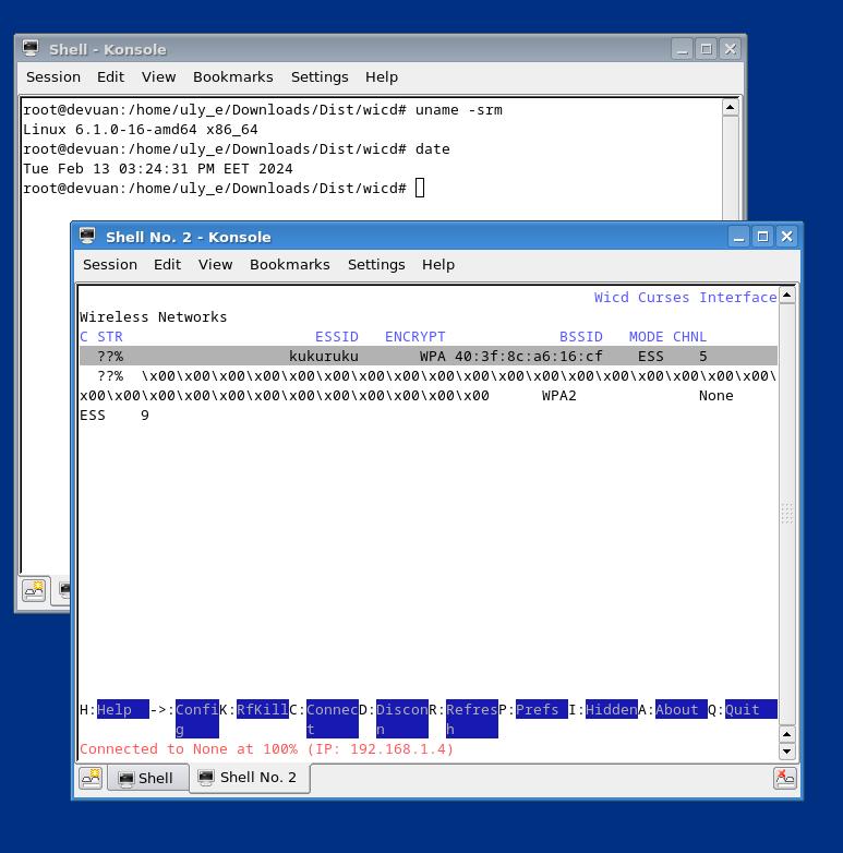

#14 2024-02-13 13:38:21
Re: Installing from src and apt
I have used WiCD for quite a few years now, quickly became second nature to do so.
Since the guy didn’t deign to answer the question “What to do in 3 months?”... smile
Wicd taken from here
https://ftp.debian.org/debian/pool/main/w/wicd/
works on Daedalus out of the box. Look at package dependencies, any python...
Here is a screenshot of the terminal and the Wi-Fi network scanned.
22.jpgimage hosting

#16 2024-02-13 17:00:52
@Альтоид
First of all, I apologize if I accidentally scratched you with my joke (there’s an emoticon there), I didn’t mean that at all.
I just downloaded these packages and installed them in my Daedalus.
This procedure is probably easier for me to do because of the full-fledged DE. There is a package manager that opens them by clicking in the file manager window, can simply do a test without installation, open a file for viewing or a window of a dependent package.
In the end, everything was installed, I stopped the network-manager service, started the wicd service and everything worked.
I don’t know if this is necessary. Just showed one of the options.
P.S.In addition to the packages in the link, a couple of python packages from the  Daedalus repository were required/

... stopped the network-manager service, started the wicd service ...
The WiCD package (1.7.4+tb2-6+devuan2) actually starts whatever you have decided to install (ie: network-manager-gnome | network-manager, etc.), so stopping it and starting WiCD would start the transitioned package again.
No matter, I still have time to think up something else.
