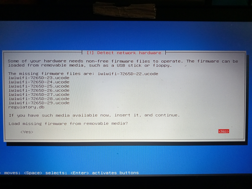

Impossible. The installer does not detect network interfaces. I've only wireless. Guess how does it know which driver to request hmm

The installer looks at your hardware and when it sees which intel wireless chip you have, it will install the firmware-iwlwifi package that it pulls from the /firmware directory inside the iso.
I want to know if you stopped the installation at the point where it asks for the driver or if you continued without it and it failed at some later point.
Normally you can ignore that request for the driver and you will be able to set up the network during the install.

I was not able to set up network interfaces. So, I've stopped here. I don't know if it's possible to install from net install without internet.(?)

I don't know if it's possible to install from net install without internet?
Sure it is. But you should specify the network and its details as if it was fully working.
BTW: most of the network drivers are part of the kernel.

It is possible to install a base system using the netinstall iso without a network connection. You get a very minimal system, and you'd have to set up the network manually after rebooting into the system. Get the firmware package from the installer usb or the iso file mounted on the system.
Is there any chance you could run the installer again and get a screenshot or camera shot of the screen that asks you to supply the wireless driver on usb stick? I'd like to have that for reference, but I can't reproduce it easily. Thanks.
#23 2025-06-16 19:51:47
Posts: 2,801
Re: No live devuan or refracta will boot on a new AMD Ryzen AI 9 HX370
I got the screenshot I wanted by installing on a laptop that has eth0 that does not work and wlan0 that does work.
https://get.refracta.org/files/misc/pro … mware.jpeg
This was an expert install of devuan_excalibur_6.0-20250605_amd64_netinstall.iso. I'm not sure if expert is necessary to get this firmware question.
I answered "no" to providing the firmware on external media and proceeded.
When it got to network detection and configuration, it only saw eth0. Since eth0 is broken, dhcp failed. I set it up manually and gave it a good local address.
When it came to setting up the package manager, I had to proceed without a mirror. While it was installing the base system, I switched to vt2 and saw that it was installing firmware-iwlwifi.
After the sofware install but before it installed grub bootloader, I opened a shell and tried to set up the wireless.
wlan0 did not show up with 'ip a'. I chrooted the installed system (in /target) and tried configuring wlan0 in /etc/network/interfaces. That didn't work. wpasupplicant was not installed. rfkill was not installed, so I couldn't see if the wireless card got switched off. That's when I gave up.
In past releases, the network setup saw the wireless hardware and let me choose whether to set up eth0 or wlan0. That didn't happen here. I'll pass this info on to the iso builder.
Reported here:
https://bugs.devuan.org/cgi/bugreport.cgi?bug=894
