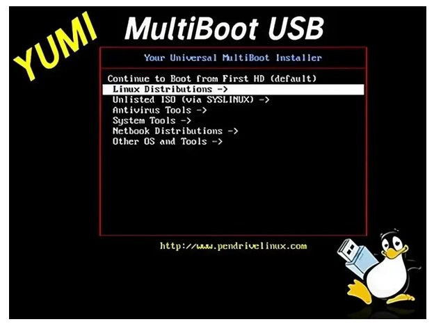

3. I can’t say anything about super_grub2, I use YUMI Legacy, all you need to do to boot the OS from your hard drive is click on the first menu item. As I understand it, it works like grub with a search for installed operating systems.
YUMI Legacy itself requires Win to install, there is YUMI exFAT, but I have little experience using it.
