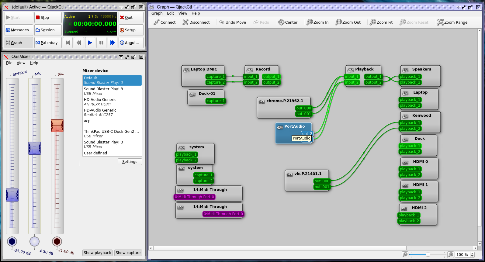

#29 2026-01-07 22:01:54
Matlib
Registered: 2022-08-25
Posts: 20
Re: ALSA+Jack system wide audio No pulseaudio or pipewire
My setup:
pcm.!default {
	type plug
	slave.pcm "jack"
pcm.jack {
	type jack
	playback_ports {
		0 Playback:input_1
		1 Playback:input_2
	capture_ports {
		0 Record:output_1
		1 Record:output_2
jackd -m -r -d dummy
For each ALSA device I'm running:
alsa_out -j $name -d hw:$card,$dev -q1
alsa_in -j $name -d hw:$card,$dev -q1
And finally empty in/out plugin creates default input and output device:
jack_thru_client Playback
jack_thru_client Record
#30 2026-01-07 22:09:53
Matlib
Posts: 20
Screenshot:

Unreal mate, that's fantastic, great setup and that screenshot looks neat. Do you use a script so it's persistent every time you boot? The way you've set that up using Alsa channel 0,1 instead of system_playback is great and jack using dummy fantastic. And the jack_thru_client, brilliant. Does alsa in and out use much cpu?
Thanks for turning my attention to JACK.
I forgot to mention that everything so far has been 0% dbus and 0% running as root.
I assembled all that manually from components I could find in JACK's distribution and it works almost perfectly. It needs some additional coding to make it user friendly though.

Big credit goes to @rations for discovering this. I've always been told that JACK was “unsuitable” and so on. It turns out that it is capable as a general purpose sound daemon if you don't mind memory usage.
