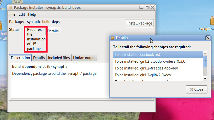

So when I double click the deb file I get a message saying it requires the installation of 115 additional packages. That's turning me off of installing it. Is there a way to install it without those 115 extra things? I mean, I already have a version installed . . . why would a simple update need an additional 115 packages when the current version doesn't?

it requires the installation of 115 additional packages. Is there a way to install it without those 115 extra things?
Yes follow the instructions on that page to build it on your system with the already existing packages you have. This is the problem with using random .deb files built by other people on their system not an exact copy of the system you are using having built it.

You're right, it wasn't installed. Anyway, here is a screenshot showing that it is saying it will install 115 more packages (trying to upgrade from the .deb file).
And here's the output of sudo dpkg -i /home/ ... /synaptic-build-deps_0.91.7_all.deb

That is not the synaptic package those are the development files you try to install. Download this package here and use the command I showed you in the last posting to install it from a Terminal.
https://download.opensuse.org/repositor … _amd64.deb
That will result in the package being installed with only seven others if memory serves me perhaps no others if you already have the Debian/Devuan package installed as it will only update the synaptic with the newer version in that case.
