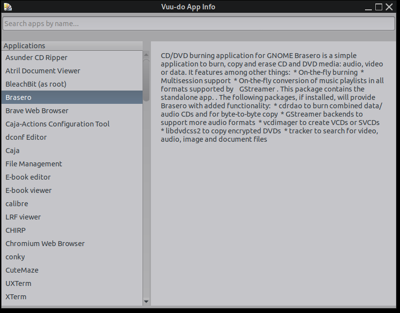

Working on a new app, the learning curve continues...
EDIT: App fininshed and packaged and uploaded for testing! https://sourceforge.net/projects/vuu-do … -App-Info/
You'll need to have yad installed as well as imagemagick. Updated pic of how it looks in post #15 in this thread.
Been screwing around most of the day with this, had never messed with C before, or compiling it so this is a first for me, awesome learning experience but omg does it ever take me forever to figure out how to do simple stuff, lol, RRQ probably could do it in 5 minutes on leafpad!
Simple app to list applications installed and a description, also has a search function that starts working as soon as you start typing, it scrapes /usr/share/applications then cross-references that list with /var/lib/dpkg/status for the description. Simple but possibly useful to the new folks I convert to linux around here. Here's a screenshot, nothing fancy and this is just the working prototype, I have a lot of work to do yet polishing up the text area as it's kinda shoved all together right now:

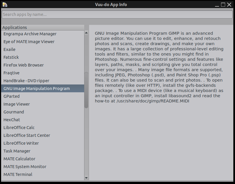

Winning! Thumbnailing this screenie, I should really have done it for the others:
Tons of work but I figured out the word-wrap issue, bullet points etc. Had to also do some functions to fix the first line of the description in /var/lib/dpkg/status, most don't caplitalize the first letter of the first word and none of them add a a period at the end of it. Whole buncha little things like that took a lot of time to sort out, but i'm pretty tickled about where it's at now, got some things to do still though.
Check out that formatting now!
