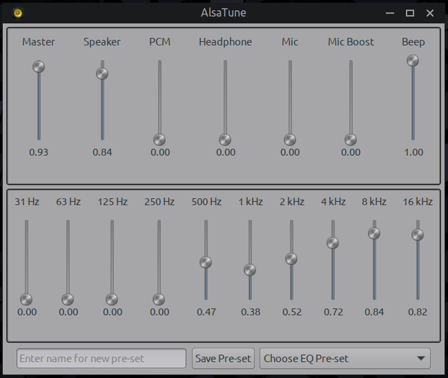

Yep, going forward i'll make a git account, just taking baby steps
right now as much as I can, this is a lot of stuff to learn. Here's what's
going on currently for anyone who might like to test:
So this app assumes that users will be alsa-purists who already have a working
alsa-only system with all the goodies including packages alsamixergui, libasound2-plugin-equal,
alsa-utils etc. And already have working terminal versions of the mixer and EQ and a
properly configured ~/.asoundrc and /etc/.asound.conf.
You must not have any sound server daemons or controls active whatsoever, no Pulse
or Pipe etc. Best not to have them installed at all. VLC drags in libpulse0, but that's
just a library and doesn't affect function.
To compile the source, you will need : GCC, libgtk-3-dev, and libasound2-dev and all their
dependencies.
So copy the code here into your text-editor, save it as "mxeq.c" in any folder you
like. The open a terminal in that same folder to compile (you don't need to be root):
gcc -o mxeq mxeq.c $(pkg-config --cflags --libs gtk+-3.0 alsa glib-2.0) -Wall
Then make the resulting binary executable, then run it, if everything is configged
properly it will be there in all it's glory! If you have Pulse running you will
get a gui with no content but a volume slider maybe, won't hurt anything, just won't
work right. Here's the source:

        const char *name = snd_ctl_elem_id_get_name(id);
        unsigned int numid = snd_ctl_elem_id_get_numid(id);
        snd_ctl_elem_iface_t iface = snd_ctl_elem_id_get_interface(id);
        if (iface != SND_CTL_ELEM_IFACE_MIXER) {
            fprintf(stderr, "Skipping non-mixer control: %s (interface=%d)\n", name, iface);
            continue;
        snd_ctl_elem_value_t *val;
        if ((err = snd_ctl_elem_value_malloc(&val)) < 0) {
            fprintf(stderr, "Failed to allocate value for control '%s': %s\n", name, snd_strerror(err));
            continue;
        snd_ctl_elem_value_set_id(val, id);
        if ((err = snd_ctl_elem_read(data->ctl, val)) < 0) {
            fprintf(stderr, "Failed to read control '%s' (numid %u): %s\n", name, numid, snd_strerror(err));
            snd_ctl_elem_value_free(val);
            continue;
        data->bands[data->num_bands].val = val;
        data->bands[data->num_bands].band_name = g_strdup(name);
        data->bands[data->num_bands].ctl = data->ctl;
        data->num_bands++;
    if (data->num_bands == 0) {
        fprintf(stderr, "No EQ bands found\n");
    snd_ctl_elem_list_free_space(list);
static void cleanup_alsa(MixerData *mixer_data, EQData *eq_data) {
    if (mixer_data->mixer) {
        snd_mixer_close(mixer_data->mixer);
        g_free(mixer_data->channels);
    if (eq_data->ctl) {
        for (int i = 0; i < eq_data->num_bands; i++) {
            if (eq_data->bands[i].val) {
                snd_ctl_elem_value_free(eq_data->bands[i].val);
            g_free((char *)eq_data->bands[i].band_name);
        snd_ctl_close(eq_data->ctl);
        g_free(eq_data->bands);
int main(int argc, char *argv[]) {
    gtk_init(&argc, &argv);
    // Set the default window icon
    gtk_window_set_default_icon_name("audio-speakers");
    MixerData mixer_data = {0};
    EQData eq_data = {0};
    init_alsa_mixer(&mixer_data);
    init_alsa_eq(&eq_data);
    // Create CSS provider for custom styling
    GtkCssProvider *css_provider = gtk_css_provider_new();
    gtk_css_provider_load_from_data(css_provider,
        "frame {"
        "  border-width: 2px;"
        "  border-style: solid;"
        "  border-color: #333333;"
        "  box-shadow: none;"
        "  border-radius: 4px;"
        -1, NULL);
    gtk_style_context_add_provider_for_screen(
        gdk_screen_get_default(),
        GTK_STYLE_PROVIDER(css_provider),
        GTK_STYLE_PROVIDER_PRIORITY_APPLICATION);
    g_object_unref(css_provider);
    // Create window
    GtkWidget *window = gtk_window_new(GTK_WINDOW_TOPLEVEL);
    gtk_window_set_title(GTK_WINDOW(window), "AlsaTune");
    gtk_window_set_default_size(GTK_WINDOW(window), 640, 510);
    gtk_window_set_position(GTK_WINDOW(window), GTK_WIN_POS_CENTER);
    g_signal_connect(window, "destroy", G_CALLBACK(gtk_main_quit), NULL);
    // Main vertical box to hold both mixer and EQ sections
    GtkWidget *main_box = gtk_box_new(GTK_ORIENTATION_VERTICAL, 5);
    gtk_container_set_border_width(GTK_CONTAINER(main_box), 5);
    gtk_container_add(GTK_CONTAINER(window), main_box);
    // Mixer frame with border
    GtkWidget *mixer_frame = gtk_frame_new(NULL);
    gtk_box_pack_start(GTK_BOX(main_box), mixer_frame, FALSE, FALSE, 0);
    // Mixer horizontal box
    GtkWidget *mixer_box = gtk_box_new(GTK_ORIENTATION_HORIZONTAL, 10);
    gtk_container_set_border_width(GTK_CONTAINER(mixer_box), 5);
    gtk_container_add(GTK_CONTAINER(mixer_frame), mixer_box);
    // Add sliders for each mixer channel
    for (int i = 0; i < mixer_data.num_channels; i++) {
        GtkWidget *channel_box = gtk_box_new(GTK_ORIENTATION_VERTICAL, 5);
        gtk_box_pack_start(GTK_BOX(mixer_box), channel_box, TRUE, TRUE, 5);
        GtkWidget *label = gtk_label_new(mixer_data.channels[i].channel_name);
        gtk_widget_set_halign(label, GTK_ALIGN_CENTER);
        gtk_box_pack_start(GTK_BOX(channel_box), label, FALSE, FALSE, 5);
        mixer_data.channels[i].scale = gtk_scale_new_with_range(GTK_ORIENTATION_VERTICAL, 0, 1, 0.01);
        gtk_range_set_inverted(GTK_RANGE(mixer_data.channels[i].scale), TRUE);
        gtk_scale_set_draw_value(GTK_SCALE(mixer_data.channels[i].scale), TRUE);
        gtk_scale_set_value_pos(GTK_SCALE(mixer_data.channels[i].scale), GTK_POS_BOTTOM);
        gtk_widget_set_size_request(mixer_data.channels[i].scale, -1, 150);
        gtk_box_pack_start(GTK_BOX(channel_box), mixer_data.channels[i].scale, TRUE, TRUE, 0);
        g_signal_connect(mixer_data.channels[i].scale, "value-changed", G_CALLBACK(slider_changed), &mixer_data.channels[i]);
        long min, max, value;
        snd_mixer_selem_get_playback_volume_range(mixer_data.channels[i].elem, &min, &max);
        snd_mixer_selem_get_playback_volume(mixer_data.channels[i].elem, 0, &value);
        gtk_range_set_value(GTK_RANGE(mixer_data.channels[i].scale), (double)(value - min) / (max - min));
        GtkWidget *padding = gtk_label_new("");
        gtk_box_pack_start(GTK_BOX(channel_box), padding, FALSE, FALSE, 5);
    // EQ frame with border
    GtkWidget *eq_frame = gtk_frame_new(NULL);
    gtk_box_pack_start(GTK_BOX(main_box), eq_frame, FALSE, FALSE, 0);
    // EQ horizontal box
    GtkWidget *eq_box = gtk_box_new(GTK_ORIENTATION_HORIZONTAL, 10);
    gtk_container_set_border_width(GTK_CONTAINER(eq_box), 2);
    gtk_widget_set_size_request(eq_box, -1, 200);
    gtk_container_add(GTK_CONTAINER(eq_frame), eq_box);
    // Add sliders for each EQ band
    for (int i = 0; i < eq_data.num_bands; i++) {
        if (!eq_data.bands[i].val) {
            fprintf(stderr, "Warning: NULL val for band %d: %s\n", i, eq_data.bands[i].band_name);
            continue;
        GtkWidget *band_box = gtk_box_new(GTK_ORIENTATION_VERTICAL, 5);
        gtk_box_pack_start(GTK_BOX(eq_box), band_box, TRUE, TRUE, 5);
        // Use shorter labels (e.g., "31 Hz" or "1 kHz")
        char short_label[16];
        const char *freq_start = eq_data.bands[i].band_name + 4;
        const char *end = strstr(freq_start, " Playback Volume");
        if (end) {
            strncpy(short_label, freq_start, end - freq_start);
            short_label[end - freq_start] = '\0';
        } else {
            strncpy(short_label, freq_start, sizeof(short_label) - 1);
            short_label[sizeof(short_label) - 1] = '\0';
        // Strip existing Hz or kHz
        char *unit = strstr(short_label, " Hz");
        if (!unit) unit = strstr(short_label, " kHz");
        if (unit) *unit = '\0';
        // Append correct unit based on frequency
        if (strcmp(short_label, "1") == 0 || strcmp(short_label, "2") == 0 || strcmp(short_label, "4") == 0 || strcmp(short_label, "8") == 0 || strcmp(short_label, "16") == 0) {
            strcat(short_label, " kHz");
        } else {
            strcat(short_label, " Hz");
        GtkWidget *label = gtk_label_new(short_label);
        gtk_box_pack_start(GTK_BOX(band_box), label, FALSE, FALSE, 5);
        eq_data.bands[i].scale = gtk_scale_new_with_range(GTK_ORIENTATION_VERTICAL, 0, 1, 0.01);
        gtk_range_set_inverted(GTK_RANGE(eq_data.bands[i].scale), TRUE);
        gtk_scale_set_draw_value(GTK_SCALE(eq_data.bands[i].scale), TRUE);
        gtk_scale_set_value_pos(GTK_SCALE(eq_data.bands[i].scale), GTK_POS_BOTTOM);
        gtk_widget_set_size_request(eq_data.bands[i].scale, -1, 150);
        gtk_box_pack_start(GTK_BOX(band_box), eq_data.bands[i].scale, TRUE, TRUE, 0);
        g_signal_connect(eq_data.bands[i].scale, "value-changed", G_CALLBACK(eq_slider_changed), &eq_data.bands[i]);
        long value = snd_ctl_elem_value_get_integer(eq_data.bands[i].val, 0);
        gtk_range_set_value(GTK_RANGE(eq_data.bands[i].scale), (double)value / 100.0);
        gtk_box_pack_start(GTK_BOX(band_box), padding, FALSE, FALSE, 5);
    // Preset controls: entry, save button, and combo box
    GtkWidget *preset_box = gtk_grid_new();
    gtk_grid_set_column_spacing(GTK_GRID(preset_box), 5);
    gtk_widget_set_halign(preset_box, GTK_ALIGN_CENTER);
    gtk_box_pack_start(GTK_BOX(main_box), preset_box, FALSE, FALSE, 1);
    GtkWidget *preset_entry = gtk_entry_new();
    gtk_entry_set_placeholder_text(GTK_ENTRY(preset_entry), "Enter name for new pre-set");
    gtk_widget_set_size_request(preset_entry, 250, -1);
    gtk_grid_attach(GTK_GRID(preset_box), preset_entry, 1, 0, 1, 1);
    GtkWidget *save_button = gtk_button_new_with_label("Save Pre-set");
    gtk_grid_attach(GTK_GRID(preset_box), save_button, 2, 0, 1, 1);
    GtkWidget *preset_combo = gtk_combo_box_text_new();
    gtk_widget_set_size_request(preset_combo, 250, -1);
    gtk_grid_attach(GTK_GRID(preset_box), preset_combo, 3, 0, 1, 1);
    // Add spacers for equal left/right margins
    GtkWidget *spacer_left = gtk_label_new("");
    gtk_grid_attach(GTK_GRID(preset_box), spacer_left, 0, 0, 1, 1);
    gtk_widget_set_hexpand(spacer_left, TRUE);
    GtkWidget *spacer_right = gtk_label_new("");
    gtk_grid_attach(GTK_GRID(preset_box), spacer_right, 4, 0, 1, 1);
    gtk_widget_set_hexpand(spacer_right, TRUE);
    // Store references for callbacks
    g_object_set_data(G_OBJECT(save_button), "preset_entry", preset_entry);
    g_object_set_data(G_OBJECT(save_button), "preset_combo", preset_combo);
    g_object_set_data(G_OBJECT(save_button), "window", window);
    // Connect signals
    g_signal_connect(save_button, "clicked", G_CALLBACK(save_preset), &eq_data);
    g_signal_connect(preset_combo, "changed", G_CALLBACK(apply_preset), &eq_data);
    // Load existing presets into combo box
    load_presets(GTK_COMBO_BOX_TEXT(preset_combo));
    gtk_widget_show_all(window);
    gtk_main();
    cleanup_alsa(&mixer_data, &eq_data);
    return 0;
#28 2025-07-12 11:09:53
tux_99
Registered: 2025-06-17
Posts: 119
Re: ALSA-only purists: Question, new GUI app for the mixer and EQ?
@greenjeans while I currently don't have a system without pulseaudio (unfortunately it's installed by default in practically every distro and AFAIK firefox requires it for sound) I tried compiling your source code in a manjaro VM (to test it in a different distro than the one you presumably developed it on). It built and run without any problems:
[testuser1@manajro-vm tmp]$ gcc -o mxeq mxeq.c $(pkg-config --cflags --libs gtk+-3.0 alsa glib-2.0) -Wall
[testuser1@manajro-vm tmp]$ ls -la
total 72
drwxr-xr-x  2 testuser1 testuser1  4096 Jul  9 19:05 ./
drwx------ 33 testuser1 testuser1  4096 Jul  9 19:04 ../
-rwx------  1 testuser1 testuser1 42808 Jul  9 19:05 mxeq*
-rw-------  1 testuser1 testuser1 20199 Jul  9 19:04 mxeq.c
I ran it too, but as you said with PA active all I got was a single volume slider as expected.
Nice job, it might come handy for me if I decide to run Devuan without Pulseaudio (need to investigate first how to keep firefox audio working without PA).

^^Yeah I got sound in FF just using alsa-only, even in my Mate systems which throw a fit when you first rip out Pulse, lol.
@tux_99 Thanks so much for testing!

^^ Thanks my friend!! I posted all this stuff i've been doing up to my sourceforge account, so anybody can test 'em and mess with 'em if they like. wink

If you have both open at the same time, adjusting either one will change the sound, but they will not update each other while both are open. It seems to me that the logic needed to do that would be difficult, involving some kind of constant polling of each other while in operation, additional code would probably have to be written for both programs.
If you register a mixer element and a callback procedure with snd_mixer_elem_set_callback(), ALSA will invoke your callback whenever a control value on that element changes.

It definitely works, but it took me a fair amount of trial and error to get it all hooked up properly. Working with ALSA is definitely fiddly, and the documentation is practically nonexistent. I wrote a fully functional ALSA system mixer last year using the Motif toolkit, for the very same reasons you started working on your mixer app. (It only covers input/outputs, though, I didn't try to implement EQ.) I set it aside at the time because I assumed there wouldn't be much interest from the general public. I'll see about getting it up somewhere that other people can take a look at it.
*EDIT: I pushed the ALSA mixer app I wrote to github: nxmixer. Maybe you will find it helpful. You will need meson to build it. The bottom of the README includes basic building instructions.
I know Motif is a strange choice, but I wanted to see what would be involved with writing a pure C GUI app without touching anything GNOME related. It was an interesting experience!

@stultumanto: Just got around to checking out your project, that looks pretty intense! Got any screenshots of it in action?

Well of course there is, i'm an idiot, lol, didn't scroll down far enough.
I probably added that screenshot after your post! smile It wasn't there when I first uploaded.
Sorry I haven't checked back here in a while, I've been super busy. As for EFL, I considered it, but I was already familiar with the X Toolkit from working with the Athena widgets. I also kind of just wanted to see if it was still possible to use Motif for anything. Believe it or not, I also wrote an ALSA mixer for GNUStep! I was exploring a lot of obscure stuff.
greenjeans, I added some stuff to your code so it would update the UI on external mixer changes. I didn't do it for the EQ controls, as I'm not familiar with the ALSA EQ plugin. But I would guess the principle is probably similar. I called out the changes with comments. There are a couple of added functions, and an added section in main(). I think that's it.
#include <gtk/gtk.h>
#include <alsa/asoundlib.h>
#include <stdio.h>
#include <string.h>
#include <glib/gstdio.h>
typedef struct {
    snd_mixer_t *mixer;
    snd_mixer_elem_t *elem;
    GtkWidget *scale;
    const char *channel_name;
} MixerChannel;
typedef struct {
    snd_mixer_t *mixer;
    MixerChannel *channels;
    int num_channels;
} MixerData;
typedef struct {
    snd_ctl_t *ctl;
    GtkWidget *scale;
    const char *band_name;
} EQBand;
typedef struct {
    snd_ctl_t *ctl;
    EQBand *bands;
    int num_bands;
} EQData;
/* ADDED SECTION: mixer event handling callbacks. */
static int elem_callback(snd_mixer_elem_t *elem, unsigned int mask) {
    if (mask == SND_CTL_EVENT_MASK_REMOVE)
        return 0;
    long current, min, max;
    snd_mixer_selem_get_playback_volume(elem, SND_MIXER_SCHN_MONO, &current);
    snd_mixer_selem_get_playback_volume_range(elem, &min, &max);
    double value = (double)current / (double)(max - min);
    gtk_range_set_value(GTK_RANGE(snd_mixer_elem_get_callback_private(elem)),
                        value);
    return 0;
static gboolean fd_dispatch(G_GNUC_UNUSED GSource *source,
                               G_GNUC_UNUSED GSourceFunc callback,
                               gpointer user_data) {
    snd_mixer_handle_events(user_data);
    return G_SOURCE_CONTINUE;
/* END OF ADDED SECTION */
// Callback to save preset to ~/.local/share/mxeq/presets.csv
static void save_preset(GtkWidget *button, gpointer user_data) {
    EQData *eq_data = (EQData *)user_data;
    GtkWidget *entry = g_object_get_data(G_OBJECT(button), "preset_entry");
    GtkWidget *combo = g_object_get_data(G_OBJECT(button), "preset_combo");
    GtkWidget *window = g_object_get_data(G_OBJECT(button), "window");
    const char *preset_name = gtk_entry_get_text(GTK_ENTRY(entry));
    if (!preset_name || strlen(preset_name) == 0) {
        GtkWidget *dialog = gtk_message_dialog_new(GTK_WINDOW(window), GTK_DIALOG_MODAL,
                                                  GTK_MESSAGE_ERROR, GTK_BUTTONS_OK,
                                                  "Please enter a preset name.");
        gtk_dialog_run(GTK_DIALOG(dialog));
        gtk_widget_destroy(dialog);
        return;
    // Check for duplicate preset name
    const char *home = g_get_home_dir();
    char *preset_path = g_build_filename(home, ".local", "share", "mxeq", "presets.csv", NULL);
    FILE *fp_check = fopen(preset_path, "r");
    if (fp_check) {
        char line[256];
        while (fgets(line, sizeof(line), fp_check)) {
            char *name = strtok(line, ":");
            if (name && strcmp(name, preset_name) == 0) {
                                                          "Preset name already exists. Choose a different name.");
                fclose(fp_check);
                g_free(preset_path);
                return;
        fclose(fp_check);
    // Create directory if it doesn't exist
    char *dir_path = g_build_filename(home, ".local", "share", "mxeq", NULL);
    g_mkdir_with_parents(dir_path, 0755);
    g_free(dir_path);
    // Open file in append mode
    FILE *fp = fopen(preset_path, "a");
    if (!fp) {
                                                  "Failed to save preset: Could not open file.");
        return;
    // Collect EQ values
    GString *values = g_string_new("");
        gdouble value = gtk_range_get_value(GTK_RANGE(eq_data->bands[i].scale));
        g_string_append_printf(values, "%.2f", value);
        if (i < eq_data->num_bands - 1) {
            g_string_append(values, ",");
    // Write preset to file
    fprintf(fp, "%s:%s\n", preset_name, values->str);
    fclose(fp);
    g_string_free(values, TRUE);
    // Add to combo box and set as active
    gtk_combo_box_text_append_text(GTK_COMBO_BOX_TEXT(combo), preset_name);
    gtk_combo_box_set_active_id(GTK_COMBO_BOX(combo), preset_name);
    // Show confirmation dialog
                                              GTK_MESSAGE_INFO, GTK_BUTTONS_OK,
                                              "Preset Saved!");
    // Clear entry
    gtk_entry_set_text(GTK_ENTRY(entry), "");
// Callback to apply selected preset
static void apply_preset(GtkComboBox *combo, gpointer user_data) {
    char *preset_name = gtk_combo_box_text_get_active_text(GTK_COMBO_BOX_TEXT(combo));
    if (!preset_name || g_strcmp0(preset_name, "Choose EQ Pre-set") == 0) {
        g_free(preset_name);
        return;
    // Build preset file path
    // Open preset file
    FILE *fp = fopen(preset_path, "r");
    if (!fp) {
        fprintf(stderr, "Failed to open presets.csv\n");
        return;
    // Read file to find matching preset
    char line[256];
    while (fgets(line, sizeof(line), fp)) {
            char *values = strtok(NULL, "\n");
            if (values) {
                char *token = strtok(values, ",");
                int i = 0;
                while (token && i < eq_data->num_bands) {
                    gdouble value = g_ascii_strtod(token, NULL);
                    gtk_range_set_value(GTK_RANGE(eq_data->bands[i].scale), value);
                    long alsa_value = (long)(value * 100.0);
                    snd_ctl_elem_value_set_integer(eq_data->bands[i].val, 0, alsa_value);
                    snd_ctl_elem_value_set_integer(eq_data->bands[i].val, 1, alsa_value);
                    snd_ctl_elem_write(eq_data->bands[i].ctl, eq_data->bands[i].val);
                    token = strtok(NULL, ",");
                    i++;
            break;
    fclose(fp);
// Load presets into combo box at startup
static void load_presets(GtkComboBoxText *combo) {
    gtk_combo_box_text_append_text(combo, "Choose EQ Pre-set");
    if (fp) {
        char line[256];
            if (name) {
                gtk_combo_box_text_append_text(combo, name);
        fclose(fp);
    gtk_combo_box_set_active(GTK_COMBO_BOX(combo), 0); // Default to "Choose EQ Pre-set"
static void slider_changed(GtkRange *range, MixerChannel *channel) {
    gdouble value = gtk_range_get_value(range);
    long min, max;
    snd_mixer_selem_get_playback_volume_range(channel->elem, &min, &max);
    long alsa_value = (long)(value * (max - min) + min);
    snd_mixer_selem_set_playback_volume_all(channel->elem, alsa_value);
static void eq_slider_changed(GtkRange *range, EQBand *band) {
    snd_ctl_elem_value_set_integer(band->val, 0, alsa_value); // Left channel
    snd_ctl_elem_value_set_integer(band->val, 1, alsa_value); // Right channel
    snd_ctl_elem_write(band->ctl, band->val);
static void init_alsa_mixer(MixerData *data) {
    if (snd_mixer_open(&data->mixer, 0) < 0) {
        fprintf(stderr, "Failed to open ALSA mixer\n");
        return;
    if (snd_mixer_attach(data->mixer, "default") < 0) {
        fprintf(stderr, "Failed to attach mixer to default device\n");
        snd_mixer_close(data->mixer);
        return;
    if (snd_mixer_selem_register(data->mixer, NULL, NULL) < 0) {
        fprintf(stderr, "Failed to register mixer\n");
        return;
    if (snd_mixer_load(data->mixer) < 0) {
        fprintf(stderr, "Failed to load mixer\n");
        return;
    const char *channel_names[] = {"Master", "Speaker", "PCM", "Headphone", "Mic", "Mic Boost", "Beep"};
    int max_channels = G_N_ELEMENTS(channel_names);
    data->channels = g_new(MixerChannel, max_channels);
    data->num_channels = 0;
    for (int i = 0; i < max_channels; i++) {
        snd_mixer_selem_id_t *sid;
        snd_mixer_selem_id_alloca(&sid);
        snd_mixer_selem_id_set_name(sid, channel_names[i]);
        snd_mixer_elem_t *elem = snd_mixer_find_selem(data->mixer, sid);
        if (elem) {
            data->channels[data->num_channels].elem = elem;
            data->channels[data->num_channels].channel_name = channel_names[i];
            data->num_channels++;
static void init_alsa_eq(EQData *data) {
    int err;
    if ((err = snd_ctl_open(&data->ctl, "equal", 0)) < 0) {
        fprintf(stderr, "Failed to open ALSA control 'equal': %s\n", snd_strerror(err));
        return;
    snd_ctl_elem_list_t *list;
    snd_ctl_elem_list_alloca(&list);
    if ((err = snd_ctl_elem_list(data->ctl, list)) < 0) {
        fprintf(stderr, "Failed to get initial control list: %s\n", snd_strerror(err));
        snd_ctl_close(data->ctl);
        return;
    int num_controls = snd_ctl_elem_list_get_count(list);
    if (num_controls <= 0) {
        fprintf(stderr, "No controls found for 'equal' device\n");
        return;
    if ((err = snd_ctl_elem_list_alloc_space(list, num_controls)) < 0) {
        fprintf(stderr, "Failed to allocate control list space: %s\n", snd_strerror(err));
        return;
        fprintf(stderr, "Failed to list controls: %s\n", snd_strerror(err));
        return;
    num_controls = snd_ctl_elem_list_get_used(list);
    data->bands = g_new(EQBand, num_controls);
    data->num_bands = 0;
    for (int i = 0; i < num_controls; i++) {
        snd_ctl_elem_id_t *id;
        snd_ctl_elem_id_alloca(&id);
        snd_ctl_elem_list_get_id(list, i, id);
            continue;
            continue;
            continue;
        data->num_bands++;
    if (eq_data->ctl) {
    /* ADDED SECTION: Set up mixer event polling. */
    int fd_ct = snd_mixer_poll_descriptors_count(mixer_data.mixer);
    if(fd_ct > 0) {
        GSource *source = g_source_new(&(GSourceFuncs){.dispatch = fd_dispatch},
                                       sizeof(GSource));
        struct pollfd *pollfds = alloca(fd_ct * sizeof(struct pollfd));
        snd_mixer_poll_descriptors(mixer_data.mixer, pollfds, fd_ct);
        for(int i = 0; i < fd_ct; i++) {
            g_source_add_unix_fd(source, pollfds[i].fd, G_IO_IN);
        g_source_set_callback(source, 0, mixer_data.mixer, NULL);
        g_source_attach(source, g_main_context_default());
        "frame {"
        -1, NULL);
    // Create window
        /* ADDED SECTION: Set element callbacks & closures for mixer events. */
        snd_mixer_elem_set_callback(mixer_data.channels[i].elem, elem_callback);
        snd_mixer_elem_set_callback_private(mixer_data.channels[i].elem,
                                            mixer_data.channels[i].scale);
            continue;
        if (end) {
        } else {
        } else {
    // Connect signals
    gtk_main();
    return 0;
#43 2025-11-23 20:32:43
Posts: 1,651
Working on 2.0
#44 2025-11-23 20:37:56
tux_99
Posts: 119
I was wondering what EQ is being controlled by your app, I assume a software EQ as sound chips don't often have a built in hardware EQ, so is this a software EQ provided by ALSA or is it built into your program (i.e. your program is doing the frequency manipulation to EQ the sound)?
Either the users control the program – or the program controls the users” Richard Stallman
#45 2025-11-23 20:48:22
Posts: 1,651
Hi tux, EQ is all done by the libasound plugin for the EQ:  libasound2-plugin-equal, so it's all native alsa doing the work, AlsaTune is just a gui frontend for the alsamixer and eq that you can access in terminal, plus some other features added like saving EQ pre-sets and such.
#46 2025-11-23 20:55:59
tux_99
Posts: 119
Ok, thanks for the info, I had never heard of this ALSA plugin (libasound2-plugin-equal) before, have to read up about it.
#47 2025-11-24 00:31:49
Posts: 1,651
It's a great little plugin, real-time global EQ, on my own machine I disable all of the mediaplayers' equalizers and set the master EQ with my own pre-sets.
#48 2025-11-24 01:49:25
stultumanto
Registered: 2023-12-12
Posts: 133
The EQ plugin is definitely nice to have. I didn't even know it was available until I ran greenjeans' mixer and saw it was looking for an EQ plugin. So I installed libasound2-plugin-equal, but I still had to do some additional setup to get it working. Putting this in my .asoundrc seemed to do the trick:
ctl.equal {
    type equal
pcm.plugequal {
    type plug
    slave.pcm "hw:0,0"
pcm.equal {
    type plug
    slave.pcm plugequal
ALSA has so many features that get overlooked. I recently discovered alsaseq (not to be confused with alsaeq) the ALSA MIDI sequencer and router. It's hard to find information online about how to use it. Search results mostly lead to the API. The alsa-utils package installs some CLI utilities, such as aconnect, aseqnet, aseqsend, and aseqdump that let you control routing. They work, but they're definitely for the technically inclined. There is a GUI app, aseqview, but it's so old it depends on GTK 1.2. I encounter this kind of thing a lot when searching for ALSA utilities. sad
