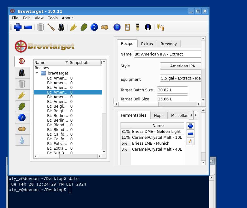

#6 2024-02-20 09:53:15
Re: [SOLVED] app wants libxalan-c
This is a link to the libxalan-c111 package.
http://ftp.de.debian.org/debian/pool/ma … _amd64.deb
Taken here
https://debian.pkgs.org/10/debian-main- … 4.deb.html
I downloaded it without problems, installed it, the synaptic shows two versions that do not interfere with each other.
Brewtarget installs and works, Daedalus 5.0.
