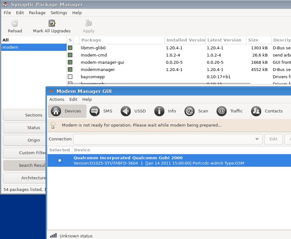

Daedalus, the laptop has a device for SIM cards, I placed a link to download the firmware on the desktop, but I have not tried the SIM card itself yet.

@aluma: I've looked for "Daedalus", but i found no modem manager named like that. Did you mean Devuan 5.0 "Daedalus"? I was curious about the modem manager's name. Or is it "Modem Manager"?

Devuan Daedalus 5.0.
The screenshot above shows the synaptic window with installed programs. This is what they are.

The screenshot did not appeared in my Opera 12. So, the name is modemmanager, thank you.
However, it was already installed and did not do anything. Should i instruct it to do something?

@TCH: there is a modemmanager-gui package which presumably interacts with the ModemManager program of the modemmanager package, and there's also the modem-manager-gui-help package with, again presumably, documentation.

I specifically posted a screenshot with the entire list.
I wonder if the problems with it are only in Opera or image hosting?
Until now, it seems that this has not happened.
Even Konqueror opens without problems for me.

As for the screenshot, take a look: http://oscomp.hu/depot/opera12_mm_screenshot.png
It does not appearing in Opera 12. But it did work from Ungoogled Chromium. (But that is not my default browser.)
