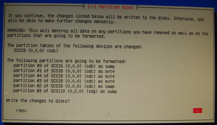

I downloaded the devuan_chimaera_4.0.0_amd64_netinstall.iso, checked it aginst its SHA256SUM and burned it to a 64Gb USB2.0 stick.
The purpose was to install it to that same USB stick.
When I got to writing the partitions I came across something strange, see for yourselves:
The USB stick I am using for the installation is SCSI8 (sdc).
SCSI6 (sdb) is my system drive and /dev/sdb3 is the swap file.
SCSI9 (sdf) is *not* partitioned and it contains a few important backup files.
Anyone knows what is going on?
PD: sorry for the lousy image system but the one I had is no longer free.

ralph.ronnquist wrote:
Have you done like that before?
Install Linux directly on a USB drive?
Most probably, long ago.
Really can't recall.
What did you expect to see?
More like what I did not expect to see.
eg: the installer informing me that ...
      - it would format partitions in drives that don't belong to the drive previously selected for the installation.
      ie: drive selected is /dev/sdc but it informs that it will format partition #3 in /dev/sdb
      - it would format an inexistent partition.
      ie: drive /dev/sdf does not have a partition #3
Obviously, this problem has an easy enough solution: take all drives in my box off-line.
But questions remain:
Why does the installer want to work on drives not selected for the installation?
Why does the installer see an inexistent partition in one of those drives?
I think that that type of thing should not happen.
Surely it can't be because the selected drive is a USB stick?

Having come to my senses, I went ahead and did it right way.  8^°
I burned the netinstall.iso to a 2.0Gb MicroSD card to install to the previously used 64Gb USB2.0 stick.
During the installation I chose to delete everything on the stick so it would start anew.
But I got the same behaviour from the installer:
Any idea as to what is happening?
Why would the installer want to muck around with a drive not selcted for installation?

How does the dialog before that one look?
#12 2023-07-28 14:00:34
Here it is:
The installation drive (USB stick) is correctly identified (VendorCo ProductCode), is the correct size (62.9GB) and is where it should be (SCSI9 /dev/sdd).
Thanks for your input.

Ok. Apparently the partitioner picks up all swap partitions (can't see sdg3 but taht'd be another swap partition). It should be possible to avoid that by deslecting those ("don't use this partition") via that previous dialog.
Apparently the partitioner picks up all swap partitions ...
Apparently so, would have to delve further into that.
But ...
Remember my first post: the installer wanted to format a partiton that did not exist.
Now, having 1) chosen to do an expert install, 2) selected specific drive to use and 3) having opted to partition it manually, I think that this should not be happening.
I did what you suggested and made sure that "don't use this partition" was used on every partition I could find that did not belong to the drive I selected for the installation and that worked.
As the other ie: /, /var and /home partitions were already established, the installer only formatted the /swap partition.
That said, why isn't every partition set up as "don't use this partition" by default?
Why does the installer pick up a /swap partition from a previously unselected drive?
I don't understand what is going on, maybe a glitch or a bug? Quite worrisome, at least to me.
In any case, I stopped the installation at 32% as it had been there for well over 15'.
I guess that installing on a 64GB USB2.0 will do that and as the damn things no longer come with the luxury of an activity LED, you really don't know if it is being written to or the install process went awry for whatever reason.
I'll try again this weekend.

a pet hate on a (brand) new SSD drive the installer auto matically selects "dos mbr" .
So I did the partitioning before the installation with a live devuan session.
I prefer GPT and using UUIDs. My drives change order all the time, UUIDs help.
Next... every time you format a partition it get a new UUID. So you should get one for that "swap" that was reformatted.
It adds a quite a bit of time to the install (and sometimes wont start) if I don't format / and /var.
This is a single user PC.
I used to have more separate system partitions, /usr /boot /usr/src /var /home
all the best.

GlennW wrote:
... comes out Like this,
... did the partitioning before the installation ...
Yes, I used to do it like that.
Every time I moved from one distribution to the next one in line.
I then settled on Devuan ~6 years ago.
I was very much used to /dev/sdx notation but eventually started using UUIDs.
Indeed ...
And your fstab gets ...  fstabbed.
Resulting in a warning about the system not finding a UUID, usually happens when you resize the /swap partition.
GlennW wrote:
... used to have more separate system partitions ...
The benefit of separate partitions for /home, /var and /swap are important.
I also use primary partitions, easier/faster to work with than primary+extended if you don't need more than four partitions.
My box has 8.0GB RAM and the 4.0GB swap partition (in my case) practically gets no use as I have priority set to -2 (it is a small SSD).
Should I need more disk space I will see about a tmpfs for swap, have been puting it off for the longest time.
With respect to the reason for this thread, I think the installer is not working properly.
ie:
Once a specific drive is selected for the installation, the default behaviour should be that no partition on any other drive be used for anything.
More yet, the installer should warn that a partition outside the selected installation drive will be used before continuing with the process.

The installer has been picking up swap files from any attached drive. since I remember, but also other distros I have used.
When I had windows I put the swap on a separate HDD and really noticed (benchmark-able) a speed increase.
That's all I got for now. Devuan is good.
(the second swap on my system is from a ubuntu-studio install that I'm playing with)
Thank you

... installer has been picking up swap files from any ...
I don't think that should happen.
You have seen it in other (Debian based?) distributions because the installer code is common to all of them.
GlennW wrote:
... put the swap on a separate HDD and really noticed ...
Yes, I also did that (another life, many years ago) when I could get my hand on another HDD.
When memory prices dropped, things changed a bit.
