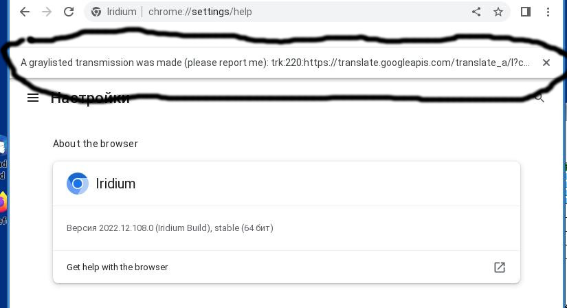

1. The latest version has an "innovation" - a warning line about using Google search, which must be manually closed.
In the previous one, it was in the address bar and disappeared by itself.
2. After some time, when viewing YouTube, the mouse cursor starts to run by itself and the browser freezes.
