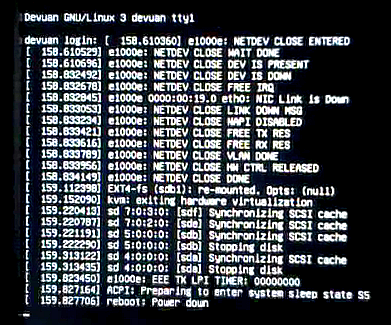

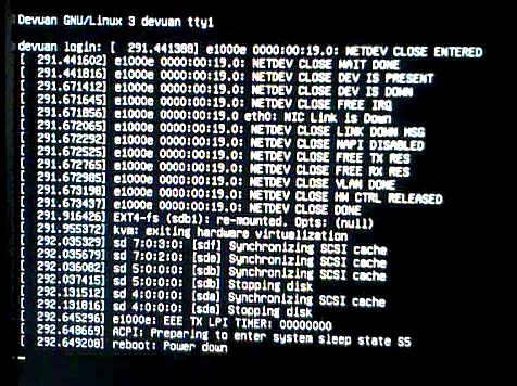

Sadly, I overlooked one function that is called in the shutdown process... in src/netdev.c. There are these functions involved: e1000e_close (netdev callback seen early in your screen capture), e1000_remove and e1000_shutdown (pci device callbacks). In e1000_shutdown, it seems that the call to e1000e_pm_freeze is just superfluous. Other shutdown callbacks handle it; without that funny unprotected call to the netdev detach function. It seems that this call can safely be removed. I will do a V3 for debug messages, tomorrow. big_smile

geki wrote:
... overlooked one function that is called in the shutdown process... in src/netdev.c.
Well ...
Looks fine to me.  8^)
geki wrote:
... these functions involved: e1000e_close (netdev callback seen early in your screen capture), e1000_remove and e1000_shutdown (pci device callbacks).
OK.
geki wrote:
... e1000_shutdown, it seems that the call to e1000e_pm_freeze is just superfluous.
So ...
I see you're still discovering e1000e fun.
geki wrote:
... do a V3 for debug messages, tomorrow.
Whenever you can.
Thanks in advance,
Best.

And from the video grab on shutdown:
I guess we now wait  ....

JFYI, that  warning is not mine. big_smile And that EEE TX LPI TIMER message is actually good. NULL means nothing active. cool That is just a debug message, e heh, they did not remove yet.
#63 2021-05-04 08:00:38
Posts: 1,826
Re: Linux e1000e module removal and e1000e EEE timer - Part II
geki wrote:
... that warning is not mine.
Did not think so.
I expect that it is from Makefile.
Because: ISO C90, mixed declarations, code, syntax?
I thought the value 00000000 meant the timer was active and at that point in the process had reached a value of nought.
Rather misleading.
geki wrote:
... just a debug message ...
... they did not remove yet.
I see ...
Left over from the original primary Intel driver e1000e module code?
Seems very sloppy. 8^/
Right.
If all is well up to now (sort of got the hang of it), booting with e1000e_3.8.7+*.patch 1000-4000 and shutting down in a standard manner, then we just have to wait.
I'll post back as soon as I get something.
Thank you so very much for your help.

Humm, I got confused. big_smile It is just right, that that message pops up there.... Though, your last screenshot of shutdown did not show any of the "PCI REMOVE" debug messages. Is that screenshot taken with the very latest patched moule build?
#67 2021-05-04 20:25:07
Posts: 1,826
geki wrote:
... just right, that that message pops up there ...
OK.
geki wrote:
... last screenshot of shutdown did not show any of the "PCI REMOVE" debug messages.
I did didn't compare them. (sorry, typo)
geki wrote:
... screenshot taken with the very latest patched moule build?
Just checked.
The time stamp on the video frame is 20210503 at 19:14 local time.
The only patching that day.
The sequence starts at 291.441602 and ends at 292.649208.
Same as what I uploaded to postimages.org
To keep tabs on myself, I posted the sequence of the patching taken directly from the tty1 output and did not change the *.patch file names.
To make sure everything was truly uncontaminated, I used a freshly unpackaged content of e1000e-3.8.7.tar.gz.
Want me to check something in particular?
Looks like the PCI REMOVE debug messages only show up in dmesg.
I'll check again -> Confirmed, only in dmesg.

It asks if you want to continue or press ESC or an Fx to abort, can't recall.
Sorry, no video or grab as I was obviously not ready for it.
This has not happened in a while and although the fans running at 100% is what this bad boot has in common with the bad shutdown, I have always thought they were for different causes.
Sun Microsystems had at one time diagnosed (but evidently not bothered to fix) this problem in a Sun Product Notes *.pdf for this WS (2009) where it says it can happen and why:
Sun MS wrote:
CPU Fan Error Might Occur After Power On
If you power on the workstation before the system enters the S3 sleep
state, a CPU fan error might occur.
It also provided a workaround which consists in accessing the Management Engine (ME) BIOS Setup utility to change the power policies.
You have to set ME "Firmware Power Control" to ON and "Host Sleep States" to ON in S0, S3.
I changed "Host Sleep States" from S1, S3 to S0, S3 but every so often the CPU Fan error came around again.
[rant]
But why would I want this?
It is basically allowing Intel ME to start up you workstation remotely.
[/rant]
So I tried to set ME "Firmware Power Control" or "Host Sleep States" to OFF, effectively disabling sleep of any type in my box.
Because ...
WTHF does a server/workstation need a damn S state different than S5 for?
As a result all havok broke loose: on reboot with the box frozen at the start of the BIOS sequence, both CPU and case fans at 100%.
I was scared shitless that my new WS was done for.
Only way out was a hard shutdown, a CMOS clear and a ME BIOS reflash.
I believe that this is closely related to the fact that it is not possible to disable the on-board GbE LAN in the BIOS. (it is greyed out)
That and the Intel e1000 driver is *always* enabling WoL no matter what settings you give it.
Which is why I had WoL set to OFF both at boot and at shutdown via a shutdown script.
In any case, "Host Sleep States" is evidently set to ON and S1, (not S0) and S3.
I insisted with my attempt once again before starting the first part of this thread, with the same results.
Not as scared and more confident around the hardware than the first time I tried it, but in a sweat till I saw a working boot screen come up.
But I digress ...
Instead of aborting the boot sequence I continued to boot into Devuan, which went on without any other problem than the fans blowing continuously at 100%.
I got a copy of dmesg checked that everything was working properly and proceeded to shut down as I am usually doing these days. ie: plain shutdown -h now, no script.
The result was another bad shutdown, like the ones I usually get.
Here's the shutdown screen:
No different than what I am getting these days with a normal shutdown.
ie: contains no debug data.
I will edit the shutdown script to disable WoL as I had been doing to see if there's any change in this behaviour.
Thanks in advance,
