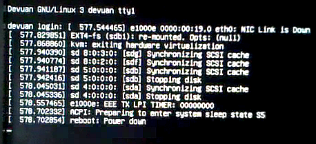

I was also certain that the hardware supported EEE, the tty1 output at shutdown was clear enough.
Devuan GNU/Linux 3 devuan tty1
devuan login: [   286.719428] e1000e: eth0 NIC Link is Down
[287.219230] e1000e: EEE TX LPI TIMER: 00000000              <-------------- | x |
[287.223022] ACPI: Preparing to enter sleep state S5
[287.223551] reboot: Power down
groucho@devuan:~$ uname -a
Linux devuan 4.19.0-16-amd64 #1 SMP Debian 4.19.181-1 (2021-03-19) x86_64 GNU/Linux
groucho@devuan:~$

The last test was to shutdown the box with a plain shutdown -h now instead of using the script I was using up to now:
groucho@devuan:~$ cat /usr/bin/shutdown.sh
# added to shutdown directly - no shutdown helper
# options added to troubleshoot nic related bad shutdown
PATH=/sbin:/bin:/usr/sbin:/usr/bin:
# sync
# disable onboard eth wol
# remove e1000e module
# shutdown system directly
sync && sudo ethtool -s eth0 wol d && sudo rmmod -s -v e1000e && sudo shutdown -h now
groucho@devuan:~$
I had been running without a bad shudown for over a week.
Not long enough to be able to say anything for certain, but still ...
Result?
Coincidental or not, a bad shutdown.
So I rebooted and shut down again, taking a video grab of the tty1 output to see what was going on when shutting down with the new e1000e module's EEE disabled.
Not good:
The line which tells me that the EEE TX LPI timer was still active was present on shudown ie: without removing the e1000e module prior to shutdown.
At this stage I don't know what to make of this.
Is EEE disabled or not?
If it is, why is the timer still active?
Most important, why can't the settings be queried?
Any comments would be appreciated.
Thanks in advance,

The screen grab video of the tty1 printout at shutdown -h now is still showing the same sequence with the line EEE TX LPI TIMER: 00000000.
To me, the tell tale sign pointing to the module is that this does not happen when using my shutdown script:
ie: removing it prior to shutdown.
# sync
It would seem that any doubts about the 82566DM-2 controller supporting EEE have been cleared:
re: /* Currently only supported on 82579 and newer */
But if this controller does not have EEE capabilty, where is this EEE TX LPI TIMER: 00000000 coming from?
And most importantly: why?
Some left over half-cooked code?
Edit 1
EEE support requires auto-negotiation with the device the NIC is connected to.
Could it be that there is some code in there that is attempting to do just that?
Up to now, by removing the module I have not had another bad shutdown (knock wood).
But it is too early to know if it holds it's only been a week.
Edit 2
Looking at the files in /e1000e-3.8.7p/src I came across this in ethtool.c:
groucho@devuan:/usr/src/e1000e-3.8.7p/src$ cat ethtool.c | grep -i "timer"
	mod_timer(&adapter->blink_timer, jiffies + E1000_ID_INTERVAL);
		if (!adapter->blink_timer.function) {
			init_timer(&adapter->blink_timer);
			adapter->blink_timer.function =
			adapter->blink_timer.data = (unsigned long)adapter;
		mod_timer(&adapter->blink_timer, jiffies);
		del_timer_sync(&adapter->blink_timer);
	edata->tx_lpi_timer = er32(LPIC) >> E1000_LPIC_LPIET_SHIFT;   <----- | x |
	if (eee_curr.tx_lpi_timer != edata->tx_lpi_timer) {           <----- | x |
		e_err("Setting EEE Tx LPI timer is not supported\n"); < ---- | x |
Thought it may have some relevance.
Thank you very much for your help and patience.

[    2.254057] e1000e 0000:00:19.0: EEE Support was initialized to be enabled
[    2.276187] e1000e 0000:00:19.0: EEE Support has been reset to be disabled
What I hoped for! big_smile It is enabled for all by default. Hooray for *****. I will check your findings, when I get some time.

Hokay, that stray EEE TX LPI TIMER:  ... comes from function e1000e_flush_lpic in src/netdev.c and seems to be a harmless print. Who dares to care?! big_smile The more fun I see in the function e1000e_pm_freeze. Both functions are called last in shutdown/reboot. Here is a discussion about the sequence: https://netdev.vger.kernel.narkive.com/ … esume-flow
    present = netif_device_present(netdev);
    netif_device_detach(netdev);
    if (present && netif_running(netdev)) {
        int count = E1000_CHECK_RESET_COUNT;
        while (test_bit(__E1000_RESETTING, &adapter->state) && count--)
            usleep_range(10000, 11000);
        WARN_ON(test_bit(__E1000_RESETTING, &adapter->state));
        /* Quiesce the device without resetting the hardware */
        e1000e_down(adapter, false);
        e1000_free_irq(adapter);
Just another dumb man's thought, should that detach not be within the if-block? roll
It seems you just have to wait for the counter+sleep to finish? smile

geki wrote:
... that stray EEE TX LPI TIMER:  ... comes from function e1000e_flush_lpic in src/netdev.c and seems to be a harmless print.
Hmmm ...
The only harmless code is the well written code.
geki wrote:
Who dares to care?!
Evidently it's only us (?)
Certainly not the hacks at Intel
Ahh ...
Then those are the ones screwing up my shutdowns.
geki wrote:
Can't make heads or tails from it.
I only know that my rig does not have any suspends enabled and the NIC does not support EEE of any sort.
It seems to me that whoever slapped together the driver did not take into account that a great deal of the code was not to be run if the part was not EEE able or if there were no S states besides S0, S1 or S5 in play.
geki wrote:
... should that detach not be within the if-block?
Seems that it is what the interruped shutdown is doing ...
But there's no sleep to finish although the counter (LX LPI Timer) is at 00000000.
It's a wonder that the damned driver works at all ...
Thanks for your input.
