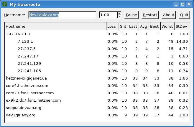

Re: [SOLVED] CLI throughput test for Linux
Hoping not to be considered indiscrete, a question if I may: how much does that service cost you?
Approximately 6.4 $/month
Using mtr is simple, in the root terminal
mtr  dev1galaxy.org
The provider asked me to submit a Winmtr report when the entire Internet was working except for access to Google. Linux mtr suited them.

... 6.4 $/month
I see ...
Is that € or US$?
If US$, when I get my fibre link installed, I will be paying ~ 1.8x that amount.
Now that's competition. 8^¡
... mtr is simple ...
Thanks for the image.
With my loaned wifi connection, I have these hostnames:.
192.168.0.1 with 0.0% loss (makes sense)
??? with 100% loss
??? with 100% loss
??? with 100% loss
??? with 100% loss
host39.181-89-51.telecom.net.ar with an upwards variating 91.5% loss, probably because it is wifi.
Every other hop (seven in all) has 0% loss, all the way to dev1galaxy.org.
Thanks for your input.
@Altoid
These are US dollars.
My mtr picture is also WiFi, home.
The top line is the router, the next 5 are the provider nodes.

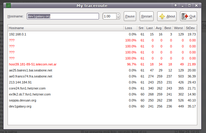

Posts: 1,978
... top line is the router ...
... next 5 are the provider nodes.
For completeness' sake:
As you can see (for whatever reason) the provider for my loaned wifi link does not list the node IPs.
No matter, it is a broadband CATV to modem + internet service and I do not ever watch television.
Not the one I will be dealing with.
Thanks a lot for your input.

Posts: 365
The nodes with ??? for their IP address will have been configured to not send ICMP responses when a packet reached its max hops. So mtr can't tell what their IP address is. But the link looks OK because the later stages are responding OK.

Posts: 1,978
chris2be8 wrote:
... have been configured to not send ICMP responses ...
I just noticed something.
Just out of curiosity ...
What about the node that does not have have ??? for its IP address?
ie:
Hostname                                   Loss
host39.181-89-51.telecom.net.ar            97.6%
Isn't a 97.6% loss rather high?
Is it possible to improve that metric?
I take it that it is between the wireless router and host39.181-89-51.telecom.net.ar, right?
My DIY tin-can waveguide antenna affords me (given the distance/walls to the router) a nice strong ~80% signal most of the time.

Posts: 1,611
Apparently your ping channel to Argentina is lossy

Posts: 365
That's past my knowledge of networking. It seems to have only replied to 2 of the 61 test packets sent to it. But passed on all the packets sent to later links.
If you are really interested you could ping it and see how often it replies. But it's probably won't get you anywhere unless you ask the telco that owns it, who probably won't be interested because it's passing packets on OK.
host host39.181-89-51.telecom.net.ar should tell you it's IP address. But again that isn't likely to tell you anything useful.

Posts: 1,978
chris2be8 wrote:
... seems to have only replied to 2 of the 61 test packets ...
Yes, that is what it does, always with a 90% to 100% packet loss.
chris2be8 wrote:
... ping it and see how often it replies.
I tried that but it needs the IP.
chris2be8 wrote:
host host39.181-89-51.telecom.net.ar should tell you it's IP...
Unfortunately not.
~$ host host39.181-89-51.telecom.net.ar
Host host39.181-89-51.telecom.net.ar not found: 3(NXDOMAIN)
It was just curiosity.  8^°
Thank you very much for your input.

traceroute to dev1galaxy.org (136.243.229.210), 30 hops max, 60 byte packets
 1  192.168.0.1 (192.168.0.1)  37.305 ms  37.240 ms  37.220 ms
 2  * * *
 3  * * *
 4  * * *
 5  * * *
 6  * * *
 7  ae25.baires1.bai.seabone.net (195.22.220.56)  23.835 ms  26.231 ms  19.157 ms
chris2be8 wrote:
... traceroute -n ... to get just the IP ...
That did it.
But it does not get done consistently, if repeat the command you get * * *.
~$ traceroute -n dev1galaxy.org
 1  192.168.0.1  10.734 ms  10.703 ms  10.675 ms
 2  * * *
 3  * * *
 4  * * *
 5  * * *
 6  181.89.51.39  120.594 ms * *                            # this should be host39.181-89-51.telecom.net.ar
 7  195.22.220.56  110.130 ms  31.578 ms  31.562 ms
 8  * * 195.22.211.209  261.653 ms
 9  213.144.184.91  261.631 ms * *
10  213.239.224.109  276.959 ms 213.239.224.181  312.183 ms 213.239.224.77  312.162 ms
11  213.239.245.110  312.146 ms 213.239.245.150  324.733 ms  324.724 ms
12  5.9.97.46  324.693 ms  324.649 ms  324.623 ms
13  136.243.229.210  324.607 ms  238.097 ms  279.641 ms
chris2be8 wrote:
... mtr might have an option ...
No, it does not have that feature.
No matter.
We beat the system and found the IP.  8^D

@Altoid
And if you set the local site (*.ar) in mtr, are the packets also lost?
