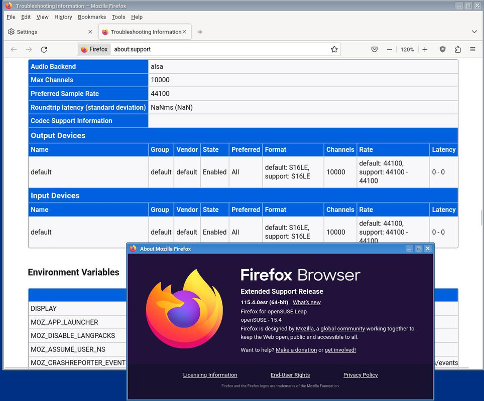

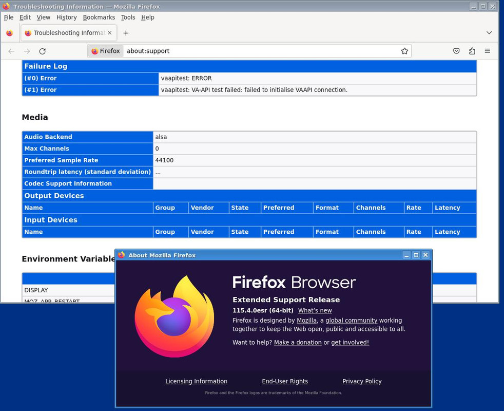

The computer has two OSes - openSuse 15.4 and Daedalus.
Both are only from ALSA, without pulseaudio.
The FF versions are the same, but openSuse has sound in the browser, but Daedalus does not.
Other Daedalus programs have sound, incl. and in the Brave browser.
There is no sound device defined in the FF Daedalus settings.
Here are the screenshots
Daedalus
openSuse
Can anyone suggest a solution?

Everything is simple with the log, there are no Output Devices, this is from the Troubleshooting Information of Forefox itself.
