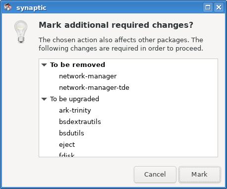

#6 2023-11-26 18:41:25
Re: Seriously?
Do you want to laugh?
I just clicked “Magk All Upgrades” in the synaptic and this is what I saw
This is Daedalus 5.0
