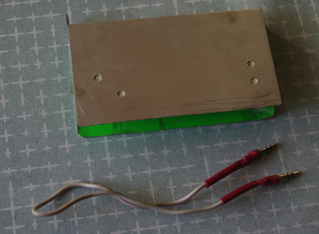

So, the scientific approach (like a pro in measurement systems):
The goal - is an objective comparison of the effect on the sound of different resamplers and different systems (ALSA, pipeware, pulseaudio, etc.).
Method - instrumental measurements.
This requires another computer with a more or less high-quality sound card (I use audigy2, 24 bit, 195 kHz), an input/output connecting wire and two programs:
- RightMark Audio Analyzer (rmaa6) for measuring all parameters of the sound card being tested.
- SpectraLab or Linux analog for measuring distortion of specific signals.
Further, there are many possibilities, for example, by recording a pure sinusodal signal from a generator with a frequency of 1 kHz and measuring the distortion when it is played back in different versions of the system, we can objectively evaluate the comparison of alsa vs pipeware vs pulseaudio. Or various resamplers.
The photo shows my primitive cord and an example of wasted work - the electrostatic screen for the Yamaha 724 sound card, according to the measurement results, turned out to be absolutely useless.
