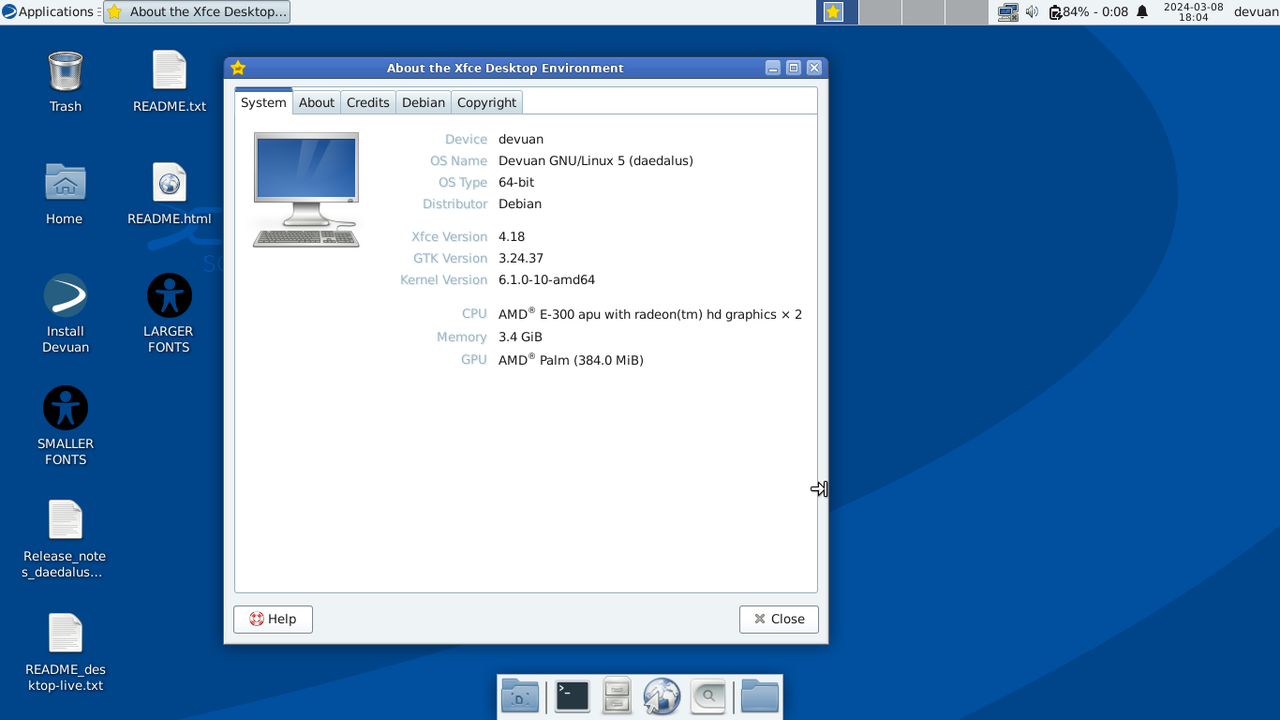

Everything is already there, done at a high professional level, and works out of the box.
Called devuan_daedalus_5.0.0_amd64_desktop-live.iso.
And I doubt that anyone will be able to “briefly” summarize dozens of pages of WIFI documentation to the topicstarter.
Well, don’t spoil the Devuan!
