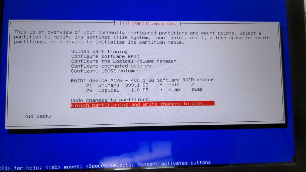

#32 2022-12-12 19:57:14
dcolburn
Registered: 2022-11-02
Posts: 280
Re: [SOLVED] How to get hardware info
This is what I'm looking at ...
FluxBB Devuan setup step 11
#33 2022-12-12 21:59:09

When you look on your screenshot in post #25 at SCSI1 #1, there is an EPS = efi. You have a relatively recent HW, so an efi installtion is advisable.
But: I am out with any RAID stuff. I have tried U320 SCSI RAIDs on Windows XP and 7, and damned them as unreliable, no matter if RAID0 for speed or RAID1 for some sort of backup. All my Linux boxes are running either from a single HD on very old stuff, on newer units SSD or NVME. RAID is no backup. It just complicates things (for me at least).
To delete something that has been set: select the partition by moving the cursor to it, them you can set properties or even delete that partition.
