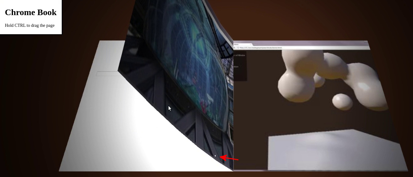

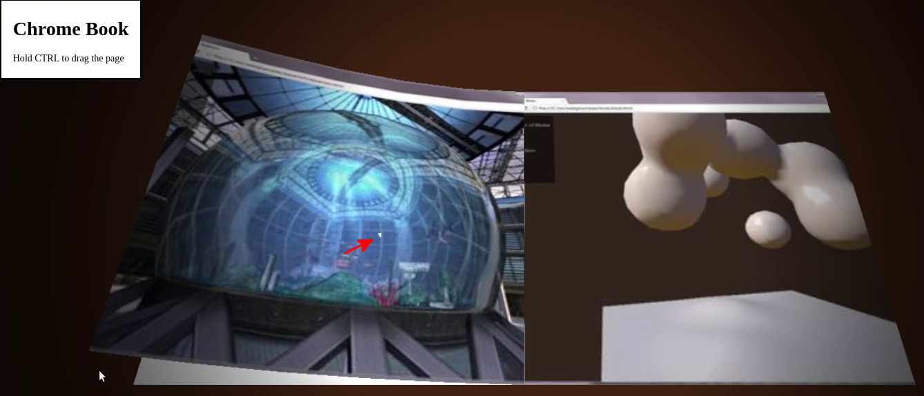

But there is still the same issue as with the Intel driver: dots appearing on 3d objects. (See screenshots of the book animation below)
thumb_show.php?i=vdj7w6czj
thumb_show.php?i=2yfb9p45t
Installing a newer kernel from stable-backports did not change anything.
