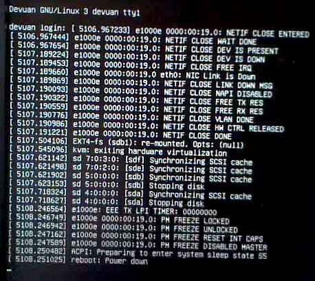

Edit 1:
This is what the shutdown tty1 output (not a bad one) looks like.
Edit 2:
Sorry, I uploaded the wrong image ... 8^/
Now we are seeing your debug messages.  8^D
Also found this in dmesg, had never looked at it by pci bus numbers:
[    1.080260] pci 0000:00:19.0: [8086:10bd] type 00 class 0x020000
[    1.080275] pci 0000:00:19.0: reg 0x10: [mem 0xf5fc0000-0xf5fdffff]
[    1.080282] pci 0000:00:19.0: reg 0x14: [mem 0xf5ffe000-0xf5ffefff]
[    1.080288] pci 0000:00:19.0: reg 0x18: [io  0xac00-0xac1f]
[    1.080335] pci 0000:00:19.0: PME# supported from D0 D3hot D3cold      <---- | x |
From here on, I will be shutting down without previously removing the module.
Let's see what happens now.
Thanks a lot for your input.  8^)

#47 2021-05-02 11:38:31
Posts: 2,132
Re: Linux e1000e module removal and e1000e EEE timer - Part II
geki wrote:
... procedures are quite similar in many business/work processes.
I think that in the end it is doing things like you are used to doing them.
Either in specific known things or adapting the learnt methods to other unknown things.
Sorry if I sound like I am channeling Rumsfeld ...  8^/
Back in early 2019, posted to a Sourceforge Intel Ethernet Drivers and Utilities page and received this interesting answer: https://sourceforge.net/p/e1000/bugs/635/#d3ba .
Besides the tech's slip, which seems to be much more sincericide than a lapsus linguae, 2012 marked the last of interactive support for this driver, so at Linux and much more so at Devuan, we're on our own.
And whatever RHE does for it, be sure the source code won't be available.
You've discovered interesting/fun facts: EEE seems to be enabled by default for anything and everything using this module and enabling SmartPowerDownEnable reports itself as Enabled in spite of the hardware not supporting it.
Makes me wonder how many more fun tidbits there are lurking inside the code.
Any leeway I can help you make with respect to this module will of great advantage to the Linux community.
Is there any NIC related test you'd need for me to carry out while we wait for a bad shutdown?
Thanks in advance,
Note: check previous post again - uploded the correct tty1 screen grab.
#48 2021-05-02 18:20:17
geki
Registered: 2019-02-04
Posts: 106
Actually, nothing more to test. It works but the confused initialization and shutdown. Let's see where it hangs in the end. I wonder, if the NETIF CLOSE callback is run in another thread than the PM FREEZE callback. And that they sporadically block each other with that stray detach call, which is obviously wrong in that scope. big_smile
#49 2021-05-02 19:06:51
Posts: 2,132
geki wrote:
... nothing more to test.
Good.
Which could eventually be corrected.
eg: EEE being enabled for all hardware / SmartPowerDownEnabled not doing anything but reporting it is.
Q:
I see the e1000e: EEE TX LPI TIMER: 00000000 line is still present at shutdown.
Wasn't EEE disabled with the first patch you wrote?
Yes, actually looking forward to a bad shutdown.
But it is absolutely impredictable and aleatory.
Never been able to reproduce it.
Typical.
When you do want something to happen ...
geki wrote:
I wonder, if the NETIF CLOSE callback is run ...
... sporadically block each other with that stray detach call ...
If I knew what that was all about ...
Thanks in advance,
#50 2021-05-02 21:10:27
geki
Posts: 106
Well, if it is not happening always, it is most likely an issue with concurrent access to one resource. In this case the netdev resource on shutdown.
This may help, also mentioned in that mailing list thread: https://www.kernel.org/doc/htmldocs/net … -lock.html
