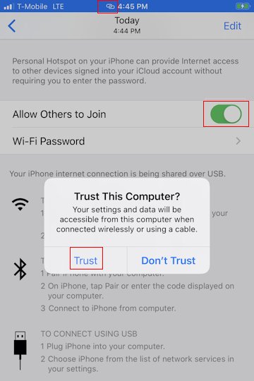

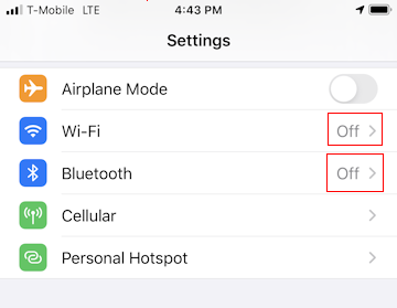

Configure your Iphone for USB Testering
Turn WiFi and Bluetooth off on your Iphone
WiFi and Bluetooth Off
Turn on Allow Others to join
Internet Sharing On
Connect
When you use your lighting to USB cable to connect your Iphone to your Devuan Beowulf machine, the following message should almost immediately appear on your Iphone.
Trust
The blue bar on the top of screen and the symbol next to the time indicates that your Iphone is already tethered and providing Internet Access to your Devuan Beowulf computer. Press the Trust button immediately so you can transfer files between your Devuan Beowulf computer and your Iphone. You will then be prompted for your Iphone password which you must enter. to transfer files

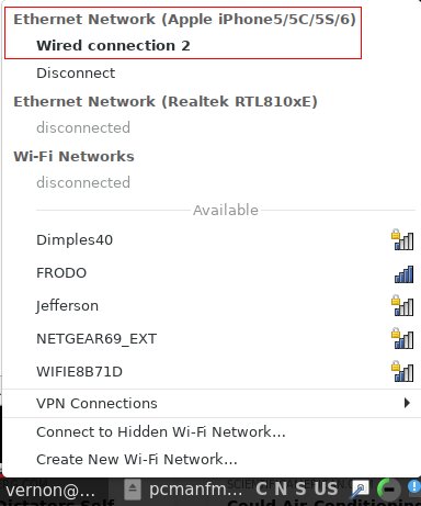

An Ethernet device has been created on your Devuan Beowulf computer which can be seen in the Network Manager applet window. Ignore the Apple IPhone 5/5C/5S/6 label on the Network Manager Applet. This should work with all modern Iphones and I have tested this with the Iphone 8 and X.
Network Manager
Note that Network Manager automatically detected this device and automatically made a DHCP request to configure it. Since I already have one wired Ethernet port on my computer, the Iphone Ethernet device name is eth1. If you don't use Network Manager, you can use WiCD's Ethernet helper and even add the device name to your /etc/network/interfaces file.
