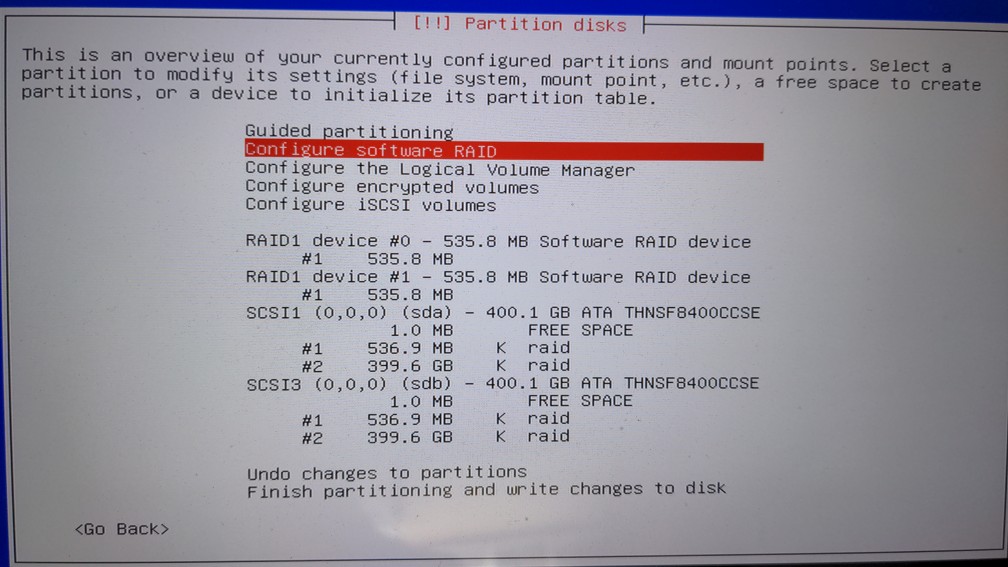

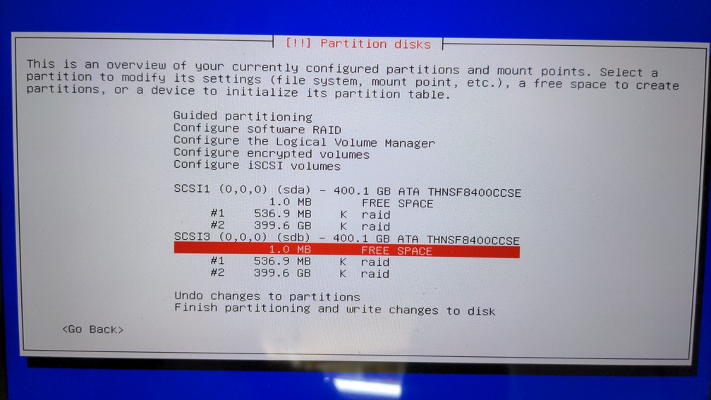

- Enter the Disk Partitioner:
--    Remove any residual config whatsoever There shall be no LVM volumes, no LV Groups, no RAID partitions, just nothing.
--    Create a 512MB primary partition, the first, on each disk and set the type to type fd (Linux RAID). (sda1 sdb1)
--    Create a very big primary or extended partition. the second, on each disk and set the type to fd (Linux RAID). (sda2 sdb2)
--    Go to the RAID submenu of the partitioner and create the the RAID volumes.
    (Assemble sda1 and sdb1 to md0, and sda2 and sdb2 to md1)
--    Now back in the main partition menu, define md0 as the /boot partition (ext3 or ext4)

A few notes:
Never, in the whole server's life, access RAID or LV members or elements of it. That is a sure way to hell. The only exception is the grub-install after kernel- or GRUB-updates.
RAIDed Volumes are accessed using /dev/md0 (for mounting, fsck etc) but don't touch /dev/md1 in our case.
Logical Volumes are accessed using /dev/mapper/VGx-lv-yyy (for mounting, fsck etc)
All filesystem activities as also backups etc have to access the corresponding mountpoints.

OK, so I used fdisk to clear out the old and build the new partitions.
That included Type #29 for Linux RAID.
I then returned to the Install and Disk Partitioner.
https://www.sun2save.com/images/misc1/n … tempt1.jpg
I followed the steps there to "create the RAID volumes" ...
https://www.sun2save.com/images/misc1/n … tempt2.jpg
Do things look OK to this point, please?

Correct alignment requires that the partitions start at sector 2048 (for a disk with 512 byte sectors, as yours seems to be) with subsequent partitions aligned to 1MiB boundaries.
Reference: https://wiki.archlinux.org/title/Advanc … _alignment
Those screens say the partitions start at "1.0 MB" but 1MB is not the same as 1MiB (2048 512 byte sectors or 1,048,576 bytes). I don't know if that screen is actually showing MB or if it is showing MiB but displaying the wrong units. You will have to check that yourself.

When I used fdisk the stated first partition sector default was 2048 - so I accepted the default. It should be OK.
I'll now need the folks who use RAID to instruct me if I got that part correct as well.
Thanks!

your disk partitioning looks right (https://www.sun2save.com/images/misc1/newpartitionattempt1.jpg)
But how have you assembled the RAID devices? RAID Device 0 should become md0 and contain /dev/sda1 and /dev/sdb1
RAID Device 1 should become md1 and consist of your bigger partitions, sda2 and sdb2
You can do that in your installer program, in the "Configure Software RAID" sub-menu and it does the job right.
Once you have md0 and md1, you can proceed following the instructions. md0 should be your /boot partition. md1 is an excellent base for a LVM2 Volume Group vg0.
Good luck!
