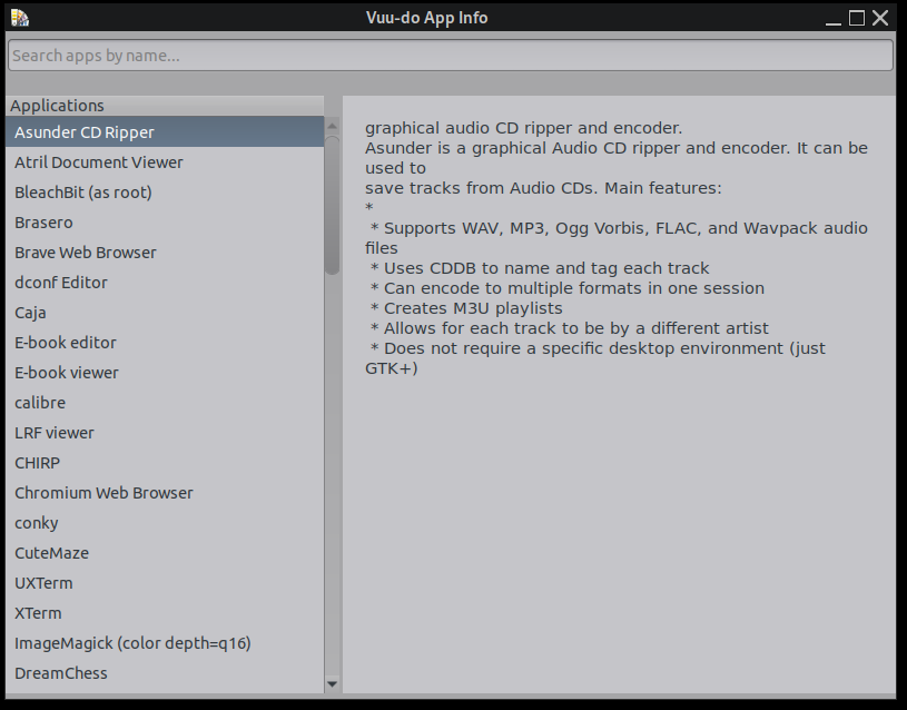

Working on a new app, the learning curve continues...

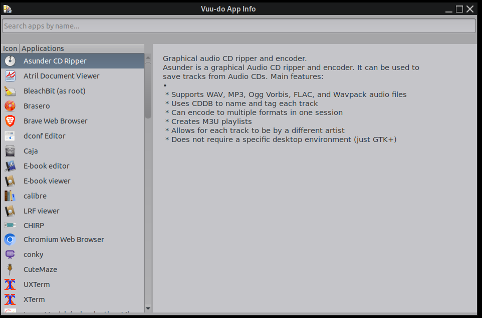

EDIT: App fininshed and packaged and uploaded for testing! https://sourceforge.net/projects/vuu-do … -App-Info/
You'll need to have yad installed as well as imagemagick. Updated pic of how it looks in post #15 in this thread.
Been screwing around most of the day with this, had never messed with C before, or compiling it so this is a first for me, awesome learning experience but omg does it ever take me forever to figure out how to do simple stuff, lol, RRQ probably could do it in 5 minutes on leafpad!
Simple app to list applications installed and a description, also has a search function that starts working as soon as you start typing, it scrapes /usr/share/applications then cross-references that list with /var/lib/dpkg/status for the description. Simple but possibly useful to the new folks I convert to linux around here. Here's a screenshot, nothing fancy and this is just the working prototype, I have a lot of work to do yet polishing up the text area as it's kinda shoved all together right now:

Yeah Yad + shellscript was my first instinct as it's my go-to for so many things, but just couldn't get it to look and act right. Also tried using webkit to make a little browser basically as i've had some luck on another app doing that and python for the rest, but still no luck. Finally used C and just plain ol gtk and that worked insanely well and fast for the GUI, took a fair amount of tries but i'm happy with it. The separate scraper script is done in bash.
Got to looking at yad while trying to work that out, fired up the yad-icon-browser which was super-close to what I wanted, and I always figured since it came packaged with yad that it was made with yad, lol, nope. Binary file written in C so I really don't understand why it's packaged with yad as there is almost no yad in it whatsoever. But....
The source code for it is very small, and it was just a matter of stripping out a lot of it that I didn't need, then re-writing it a bit to scrape a text file for content rather than the icons. I'm using that text file created by the scraper script instead of sqlite for a database. One of the goals here was to NOT have to install extra depends for this over and above what's typically on a basic system, keeping it simple, small, and fast and doing one job well.
Still need to fine-tune the scraper script, it's missing the description portion in about 10% of the apps, mainly ones with weird names for their .desktop files instead of straightforward ones, like Handbrake ought to be handbrake.desktop, but instead it's "fr.handbrake.ghb.desktop" and Hexchat is "io.github.hexchat.desktop", somehow that's defeating me, currently trying some new mods to the script.

Winning! Thumbnailing this screenie, I should really have done it for the others:
Tons of work but I figured out the word-wrap issue, bullet points etc. Had to also do some functions to fix the first line of the description in /var/lib/dpkg/status, most don't caplitalize the first letter of the first word and none of them add a a period at the end of it. Whole buncha little things like that took a lot of time to sort out, but i'm pretty tickled about where it's at now, got some things to do still though.
Check out that formatting now!

        continue
    fi
    # Extract Name, Exec, Comment, NoDisplay, and Categories using grep
    name=$(grep -m1 -i "^Name=" "$desktop_file" | sed 's/^Name=//')
    exec_cmd=$(grep -m1 -i "^Exec=" "$desktop_file" | sed 's/^Exec=//')
    comment=$(grep -m1 -i "^Comment=" "$desktop_file" | sed 's/^Comment=//')
    nodisplay=$(grep -m1 -i "^NoDisplay=" "$desktop_file" | sed 's/^NoDisplay=//')
    categories=$(grep -m1 -i "^Categories=" "$desktop_file" | sed 's/^Categories=//')
    # Skip if Name or Exec is empty
    if [ -z "$name" ] || [ -z "$exec_cmd" ]; then
        echo "Skipping $desktop_file: Missing Name or Exec" >> "$debug_log"
        continue
    fi
    # Skip if NoDisplay=true
    if [ "$nodisplay" = "true" ]; then
        echo "Skipping $desktop_file: NoDisplay=true" >> "$debug_log"
        continue
    fi
    # Skip if Categories contains "Settings" (case-insensitive)
    if echo "$categories" | grep -qi "Settings"; then
        echo "Skipping $desktop_file: Categories contains 'Settings'" >> "$debug_log"
        continue
    fi
    # Get package name (strip .desktop)
    pkg_name=$(basename "$desktop_file" .desktop | tr '[:upper:]' '[:lower:]')
    # Get description (dpkg or fallback to Comment)
    desc="${dpkg_desc[$pkg_name]:-$comment}"
    # If no description from dpkg or falls back to comment, try matching term
    if [ -z "$desc" ] || [ "$desc" = "$comment" ]; then
        new_pkg_name=$(find_matching_term "$desktop_file" "$pkg_name")
        desc="${dpkg_desc[$new_pkg_name]:-$comment}"
        echo "Retried description for $name with package $new_pkg_name" >> "$debug_log"
    fi
    # Final fallback
    desc="${desc:-No description available}"
    # Add period to first line if missing
    first_line=$(echo "$desc" | head -n 1)
    if [[ ! "$first_line" =~ \.$ ]]; then
        desc=$(echo -e "$first_line.\n$(echo "$desc" | tail -n +2)")
    fi
    # Escape newlines for storage
    desc=$(echo "$desc" | tr '\n' '\v' | sed 's/\v/\\n/g')
    # Write to output file (format: Name|Exec|Description)
    echo "$name|$exec_cmd|$desc" >> "$output_file"
    ((count++))
    echo "Added $name to output" >> "$debug_log"
done
shopt -u nullglob
echo "Scraped $count apps from $desktop_dir" >> "$debug_log"
echo "Output written to $output_file" >> "$debug_log"
echo "Debug log: $debug_log"
# Add test app if no apps were scraped
if [ "$count" -eq 0 ]; then
    echo "No apps scraped, adding test app" >> "$debug_log"
    echo "TestApp|echo 'Test App'|Test application" >> "$output_file"
    ((count++))
    echo "Added TestApp to output" >> "$debug_log"
fi
echo "Total apps scraped: $count" >> "$debug_log"
#define _GNU_SOURCE
#include <gtk/gtk.h>
#include <stdio.h>
#include <string.h>
#include <stdlib.h>
#include <ctype.h>
#define MAX_LINE 4096
// Struct to hold app data
typedef struct {
    char *name;
    char *description;
} AppData;
// Global app list
AppData *apps = NULL;
int num_apps = 0;
// GTK widgets
GtkWidget *window;
GtkWidget *app_list_view;
GtkListStore *app_store;
GtkWidget *desc_view;
GtkTextBuffer *desc_buffer;
GtkWidget *search_entry;
// Get dynamic data file path
char *get_data_file_path() {
    char *home = getenv("HOME");
    if (!home) {
        g_print("Error: Cannot get HOME environment variable\n");
        return NULL;
    char *path = malloc(strlen(home) + strlen("/.local/share/vai/scraped_apps.txt") + 1);
    sprintf(path, "%s/.local/share/vai/scraped_apps.txt", home);
    return path;
// Capitalize first letter of the description
char *capitalize_first_letter(const char *desc) {
    if (!desc || strlen(desc) == 0) return strdup(desc);
    char *result = strdup(desc);
    if (islower(result[0])) {
        result[0] = toupper(result[0]);
    return result;
// Process description to format bullet points and paragraph separators
char *format_description(const char *desc) {
    if (!desc || strlen(desc) == 0) return capitalize_first_letter("No description available");
    // Allocate enough space for formatted description
    char *result = malloc(strlen(desc) * 2 + MAX_LINE);
    char *current = result;
    const char *p = desc;
    int line_start = 1;
    char indent[] = "    ";
    char bullet[] = "• ";
    while (*p) {
        if (line_start && (*p == '*' || *p == '.')) {
            // Peek ahead to check if this is a bullet point or paragraph separator
            const char *next = p + 1;
            int spaces = 0;
            while (*next == ' ') {
                spaces++;
                next++;
            if (*next == '\n' || *next == '\0' || (*next == '\\' && *(next + 1) == 'n')) {
                // Paragraph separator: add fat bullet without indent
                strcpy(current, bullet);
                current += strlen(bullet);
                p += 1 + spaces; // Skip marker and spaces
                if (*p == '\\' && *(p + 1) == 'n') {
                    p += 2; // Skip \n
                    *current++ = '\n'; // Add newline after separator
                line_start = 1;
            } else {
                // Bullet point: add indent and bullet
                strcpy(current, indent);
                current += strlen(indent);
                line_start = 0;
                // Copy the rest of the line
                while (*p && !(*p == '\\' && *(p + 1) == 'n') && *p != '\n') {
                    *current++ = *p++;
                *current++ = '\n'; // Add newline after bullet point
                line_start = 1;
        } else if (*p == '\\' && *(p + 1) == 'n') {
            // Handle explicit newlines
            p += 2; // Skip \n
            *current++ = '\n';
            line_start = 1;
        } else {
            // Copy character as-is, preserving spaces
            *current++ = *p++;
            line_start = 0;
    *current = '\0';
    char *capitalized = capitalize_first_letter(result);
    free(result);
    // Debug output
    g_print("Formatted description:\n%s\n---\n", capitalized);
    return capitalized;
// Load apps from scraped_apps.txt
void load_apps() {
    char *data_file = get_data_file_path();
    if (!data_file) {
        gtk_text_buffer_set_text(desc_buffer, "Error: Cannot get data file path", -1);
        return;
    FILE *file = fopen(data_file, "r");
    if (!file) {
        char err_msg[256];
        snprintf(err_msg, 256, "Error: Cannot open %s", data_file);
        gtk_text_buffer_set_text(desc_buffer, err_msg, -1);
        free(data_file);
        return;
    char line[MAX_LINE];
    int capacity = 100;
    apps = malloc(capacity * sizeof(AppData));
    num_apps = 0;
    while (fgets(line, MAX_LINE, file)) {
        // Remove trailing newline
        line[strcspn(line, "\n")] = '\0';
        // Parse line: Name|Exec|Description
        char *name = strtok(line, "|");
        if (!name) continue;
        char *exec = strtok(NULL, "|");
        if (!exec) continue;
        char *desc = strtok(NULL, "\0"); // Capture entire description
        if (!desc) desc = "No description available";
        // Debug raw description
        g_print("Raw description for %s:\n%s\n---\n", name, desc);
        // Format description
        char *clean_desc = format_description(desc);
        if (num_apps >= capacity) {
            capacity *= 2;
            apps = realloc(apps, capacity * sizeof(AppData));
        apps[num_apps].name = strdup(name);
        apps[num_apps].description = clean_desc;
        num_apps++;
    fclose(file);
    free(data_file);
    g_print("Loaded %d apps from %s\n", num_apps, data_file);
// Filter apps based on search
gboolean filter_apps(GtkTreeModel *model, GtkTreeIter *iter, gpointer data) {
    const char *search_text = gtk_entry_get_text(GTK_ENTRY(search_entry));
    if (!search_text || strlen(search_text) == 0) return TRUE;
    char *name;
    gtk_tree_model_get(model, iter, 0, &name, -1);
    if (!name) return FALSE;
    gboolean visible = strcasestr(name, search_text) != NULL;
    g_free(name);
    return visible;
// Update description pane
void on_app_selected(GtkTreeSelection *selection, gpointer data) {
    GtkTreeIter filter_iter;
    GtkTreeModel *filter_model;
    if (gtk_tree_selection_get_selected(selection, &filter_model, &filter_iter)) {
        GtkTreeIter child_iter;
        GtkTreeModel *child_model = gtk_tree_model_filter_get_model(GTK_TREE_MODEL_FILTER(filter_model));
        gtk_tree_model_filter_convert_iter_to_child_iter(GTK_TREE_MODEL_FILTER(filter_model), &child_iter, &filter_iter);
        char *name;
        gtk_tree_model_get(child_model, &child_iter, 0, &name, -1);
        g_print("Selected app: %s\n", name ? name : "NULL");
        if (name) {
            for (int i = 0; i < num_apps; i++) {
                if (apps[i].name && strcmp(apps[i].name, name) == 0) {
                    g_print("Setting description for %s\n", name);
                    gtk_text_buffer_set_text(desc_buffer, apps[i].description ? apps[i].description : "No description available", -1);
                    g_free(name);
                    return;
            g_print("No matching app found for %s\n", name);
            g_free(name);
            gtk_text_buffer_set_text(desc_buffer, "No description available", -1);
        } else {
            g_print("Failed to get app name\n");
            gtk_text_buffer_set_text(desc_buffer, "Error: Invalid selection", -1);
    } else {
        g_print("No selection\n");
        gtk_text_buffer_set_text(desc_buffer, "Select an app to view its description", -1);
// Update filter on search change
void on_search_changed(GtkEntry *entry, gpointer data) {
    gtk_tree_model_filter_refilter(GTK_TREE_MODEL_FILTER(data));
int main(int argc, char *argv[]) {
    gtk_init(&argc, &argv);
    // Create window
    window = gtk_window_new(GTK_WINDOW_TOPLEVEL);
    gtk_window_set_title(GTK_WINDOW(window), "Vuu-do App Info");
    gtk_window_set_default_size(GTK_WINDOW(window), 950, 600);
    g_signal_connect(window, "destroy", G_CALLBACK(gtk_main_quit), NULL);
    // Create main container
    GtkWidget *vbox = gtk_box_new(GTK_ORIENTATION_VERTICAL, 10);
    gtk_container_add(GTK_CONTAINER(window), vbox);
    // Search entry
    search_entry = gtk_entry_new();
    gtk_entry_set_placeholder_text(GTK_ENTRY(search_entry), "Search apps by name...");
    gtk_box_pack_start(GTK_BOX(vbox), search_entry, FALSE, FALSE, 5);
    // Paned layout
    GtkWidget *paned = gtk_paned_new(GTK_ORIENTATION_HORIZONTAL);
    gtk_paned_set_position(GTK_PANED(paned), 300); // Wide app list
    gtk_box_pack_start(GTK_BOX(vbox), paned, TRUE, TRUE, 5);
    // App list (left pane)
    app_store = gtk_list_store_new(1, G_TYPE_STRING);
    GtkTreeModel *filter_model = gtk_tree_model_filter_new(GTK_TREE_MODEL(app_store), NULL);
    gtk_tree_model_filter_set_visible_func(GTK_TREE_MODEL_FILTER(filter_model), filter_apps, NULL, NULL);
    app_list_view = gtk_tree_view_new_with_model(filter_model);
    GtkCellRenderer *renderer = gtk_cell_renderer_text_new();
    GtkTreeViewColumn *column = gtk_tree_view_column_new_with_attributes("Applications", renderer, "text", 0, NULL);
    gtk_tree_view_append_column(GTK_TREE_VIEW(app_list_view), column);
    gtk_tree_view_set_headers_visible(GTK_TREE_VIEW(app_list_view), TRUE);
    // Populate app list
    load_apps();
        GtkTreeIter iter;
        gtk_list_store_append(app_store, &iter);
        gtk_list_store_set(app_store, &iter, 0, apps[i].name, -1);
    GtkWidget *scroll = gtk_scrolled_window_new(NULL, NULL);
    gtk_scrolled_window_set_policy(GTK_SCROLLED_WINDOW(scroll), GTK_POLICY_AUTOMATIC, GTK_POLICY_AUTOMATIC);
    gtk_container_add(GTK_CONTAINER(scroll), app_list_view);
    gtk_paned_pack1(GTK_PANED(paned), scroll, FALSE, FALSE);
    // Description pane (right)
    desc_view = gtk_text_view_new();
    gtk_text_view_set_editable(GTK_TEXT_VIEW(desc_view), FALSE);
    gtk_text_view_set_wrap_mode(GTK_TEXT_VIEW(desc_view), GTK_WRAP_WORD); // Use WORD wrap for natural text flow
    gtk_text_view_set_left_margin(GTK_TEXT_VIEW(desc_view), 10);
    gtk_text_view_set_right_margin(GTK_TEXT_VIEW(desc_view), 10);
    gtk_text_view_set_top_margin(GTK_TEXT_VIEW(desc_view), 10);
    gtk_text_view_set_bottom_margin(GTK_TEXT_VIEW(desc_view), 10);
    desc_buffer = gtk_text_view_get_buffer(GTK_TEXT_VIEW(desc_view));
    // Apply CSS for font and spacing
    GtkCssProvider *provider = gtk_css_provider_new();
    gtk_css_provider_load_from_data(provider,
        "textview { line-height: 1.5; padding: 10px; font-family: Sans; }", -1, NULL);
    gtk_style_context_add_provider(gtk_widget_get_style_context(desc_view),
        GTK_STYLE_PROVIDER(provider), GTK_STYLE_PROVIDER_PRIORITY_APPLICATION);
    g_object_unref(provider);
    gtk_container_add(GTK_CONTAINER(scroll), desc_view);
    gtk_paned_pack2(GTK_PANED(paned), scroll, TRUE, FALSE);
    // Connect signals
    GtkTreeSelection *selection = gtk_tree_view_get_selection(GTK_TREE_VIEW(app_list_view));
    gtk_tree_selection_set_mode(selection, GTK_SELECTION_SINGLE);
    g_signal_connect(selection, "changed", G_CALLBACK(on_app_selected), NULL);
    g_signal_connect(search_entry, "changed", G_CALLBACK(on_search_changed), filter_model);
    // Show all
    gtk_widget_show_all(window);
    gtk_main();
    // Cleanup
        free(apps[i].name);
        free(apps[i].description);
    free(apps);
    return 0;
[Desktop Entry]
Version=1.0
Type=Application
Terminal=false
Name=Vuu-do App Info
Exec=/home/(username)/.local/share/vai/vai.sh
Icon=edit-find
Comment=Information about installed applications.

#13 2025-06-29 12:41:58
Posts: 247
Re: Working on a new app, the learning curve continues...
Nice work and install tutorial!
Here is a short collection of incedences on my excalibur:
Compiling: pkg-config --cflags --libs gtk+-3.0 throwed an error, solved by installing libgtk-3-dev .
Scraping: There were two or three instances of the script running, beside free cpu cores.
You mentioned "/var/lib/dpkg/status" and I thought this text file would be processed to get package related information.
dpkg was querried a lot (multiple ps ax in the terminal to kill time, e.g.: dpkg-query --search -- galculator.desktop )
Sorting:
A doubled "ParaView" entry cought my attention - see code section.
Guess is:
The list is sorted by the name of the *.desktop file. The shown "Application Name" is from the 'Name="Application Name"'-field.
*Highly accurate* entries like "Document Viewer" are existing too.
I'm missing a reference to the executed binary itself.
Or maybe executable name for sorting?
**imaginary screen shot of the program list**

#14 2025-06-29 16:35:48
Posts: 970
Thanks so much for testing and posting! Interesting that you tired it on excalibur, the whole thing is built on a daedalus system, have not tested it in my own excalibur setups. Glad you figured out the libgtk3-dev package, I did mention it earlier in the thread but should ave included that as part of the install tutorial. I should have also mentioned that the scraper also creates a debug log which i'm leaving in for now until I get this thing fully tested.
Yeah the calls to dpkg would not have been necessary at all if all applications followed a simple naming convention across the board, i.e same name of the .desktop, the app itself, it's excecutable, and the name of the package itself. As I mentioned before many of these apps have one or more of those factors different than the others, in the case of some apps like the gnome-disk-utility all four were completely different, it took some hella pattern matching to get those to show up and slowed the scraper waaaaaay down.
And packages like Calibre that own multiple .desktops (in calibre's case 4 total), will currently all show the main description of calibre itself.
I tried last night to implement one of the tweaks I want to do, adding a yad progress dialog and an "all done" dialog when it finished, which should have been a piece of cake as I work with yad dialogs in shellscripts all the time, but my first attempt when I ran it caused some kind of looping error that caused the debug log to fill up rapidly way over what it should have been and not stopping! Lol. that's when I decided my brain was too tired and just going to screw up further so I shut it down for the night. But i'll get that worked out hopefully today.
My two other goals are to add icons to the left pane in front of the app names similar to the way it looks in the main menu, pain in the butt to do using the same types of parsing/matching/scraping i'm doing now, but I have an idea about using the cached icons that should already be present in ~/.cache.
Last one is implementing something to speed up the scraper, still pondering how to do that.
All this code is rough as hell, but by golly I got it to a place of good basic functionality, been one heck of a learning experience, which was the primary goal in the first place, so i'm happy. big_smile
ETA: Got the dialogs working now! Simple visual verification that something is happening, and when it's finished.

#15 Yesterday 00:15:06
Posts: 970
Right now, I smell like VICTORY! Smell it! Smell my victory!!
BOOM! *mic drop* This puppy is DONE! My first ever stand-alone application with a real GUI, and man what a learning experience!
Time to go after bigger projects now, I have it in mind to fork the crap out of the gnome-disk-utility, get rid of the bullshit CSD and fix their failure to properly wipe empty space before creating secondary partitions.
I'll post the final scripts here in a bit, kinda wiped out right now and popping the top on a cold one to take a victory lap. wink
Thank you Devuan and Dev1galaxy and all it's users for making my education possible! Beers for everyone!

#17 Yesterday 17:52:28
Posts: 970
Updated the OP, app done and packaged and uploaded! Would love it if some of you kind folks might test it out!

#18 Yesterday 23:00:01
Posts: 672
Nice work greenjeans, My first thought... how come the package managers don't have this kind of info(?).
Nice, really nice. Thank you.
#19 Yesterday 23:18:10
Posts: 970
Thanks Glenn! The thing is the package managers do have this info, at least in Synaptic, the descriptions in the app are the same ones you'd see if you opened Synaptic and went through your list of installed applications. This is just a quick and easy way to view just the apps that need explaining without having to wade through some 1200-2000 listings of all installed packages in Synaptic.
The idea is, when I convert someone to Linux, I always query them about what kinds of apps they need/want, and I roll them up a custom iso with everything they need already installed, but to a new user all the new names may be confusing, so rather than use Synaptic or open each and every program one by one, they can just click this and get a quick explanation. Obviously after that if folks install new programs from Synaptic they'll read the description there with no need really to re-run the app scraper as they chose those programs and already read the info. So after a time once they get used to using their new apps, this program will be obsoleted, but no biggie, I think it's a handy little reference to help them get up to speed quickly.
