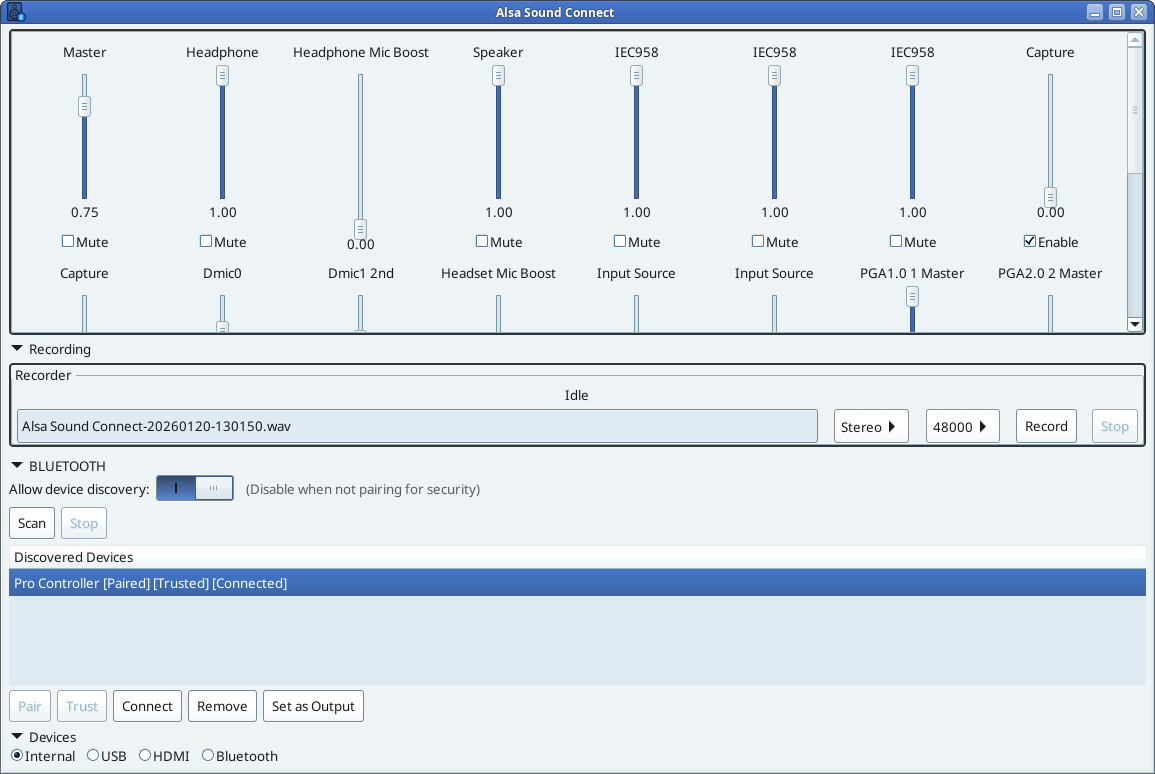

Expanded MATE desktop interface

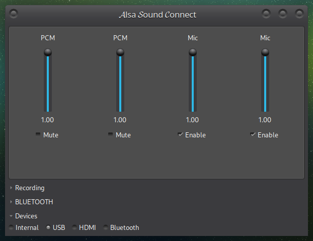

Collapsed MATE desktop USB audio interface controls

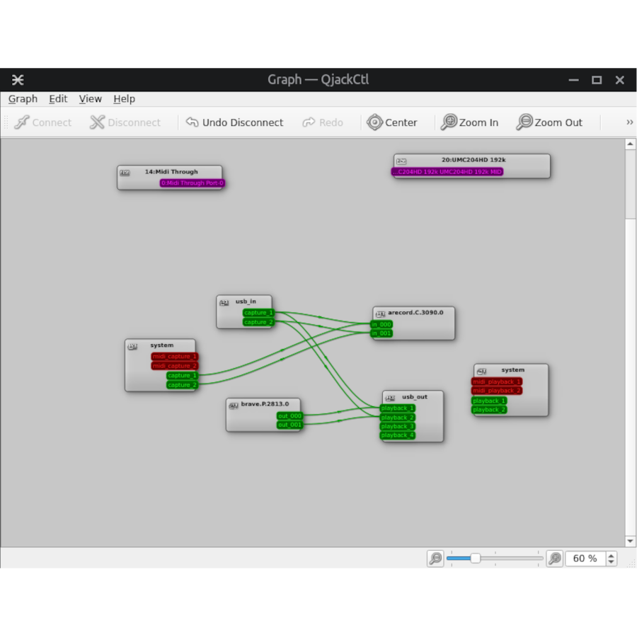

Qjackctl graph connections

Collapsed on MATE desktop
