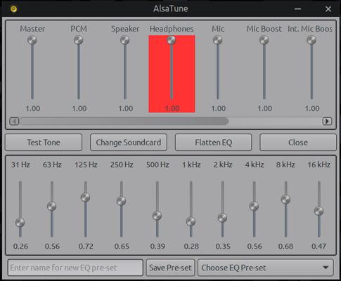

Wow that took a long time, but version 2.0-1 is almost ready.
I tried various methods for detecting a given soundcard's controls and got it working mostly, but it literally doubled the size of the binary, 100% increase in size, not acceptable for just a small addition to a tiny utility. But had a thought yesterday while working at the library. The current app has slider names hardcoded, some 7 in all, and behavior is good in that if you don't have that particular slider name on your system, it simply won't add it to the GUI. So my low cost solution to that is that I added greatly to the number of potential slider names in the script, taken from my testing of various machines, suggestions made here (thanks!) and some internet searching, so now the app supports some 54 different controls and it's super easy to add more in the future, but as-is it ought to work for 90+% of most laptops and desktops. Had to add a scrollbar obviously. Only a 10% increase in code to do it that way, main binary is still under 50k.
I also added a mute/unmute function for the volume sliders that have a mute function, rather than take up extra space in the GUI with checkboxes or whatnot, I simply made it a right-click function, so now you can right-click on volume sliders and it will toggle mute/unmute and if the channel is muted now it has a big red box over it that shows very clearly that it's muted. Certainly there's a cleaner prettier way and at some point i'll work on the visual, but for now the function is up and running and that was the main point for this update.
Please feel free to post any channel names not on my list, here's the relevant code snippet so you can see what I have now:
*snip* deprecated
Here's a screenie of the working proto (re-sized to be smaller for the forum):

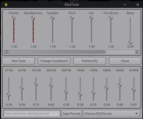

Started off today just wanting to tweak, that red color was obnoxious so I intended just to deal with that, ended up changing quite a bit and fixing a couple bugs along the way.
No more big list of channel names, finally figured out a simple way to detect that didn't drag in other depends, it's working great, pulling everything that's needed but also skipping simple toggles (i.e. auto-mute-mode, loopback etc., i'll add a function for those in a future update), soooo much less code. Fixed a bug where "Beep" was controlling the "Capture" slider. Added logic to remember what channels are muted as before the highlighting wouldn't survive re-starts.
Still only a 44.2k binary, tiny little powerhouse! Only going to get better, it's addicting I tell ya, lol. ![]()
Devuan 5 mate-mini iso, pure Devuan, 100% no-vuu-do.
Devuan 6 version also available for testing.
Mo bettah I think, what do y'all think? I like the barber pole thing, not near as obnoxious as previous version, nice and clean and simple but still easy to identify what channels are muted. This took a LOT of "stepwise refinement" today, it's embarassing really that it takes so long, I really don't like CSS.

Looks way more polished then the big red rectangle, good job. Did you have any luck with the auto detect? There is some code in the jack-bridge mxeq version that could help if you're interested. But it's generated from chat bots and I know this doesn't sit well with most people but if could give you some ideas.
SOURCEFORGE jack-bridge
Thanks!! Yeah I did finally work out the auto-detect, first round I way over thought and added a mountain of code but it kinda worked, woke up next day and threw all that out, went for stupid simple and that worked pretty good but it wasn't really the right way to do it. Finally I figured it out and it was so simple and elegant and right under my nose that i'm again kinda embarrassed but I did finally get it...just wish my first instinct in these things was the correct one a little more often, lol.
