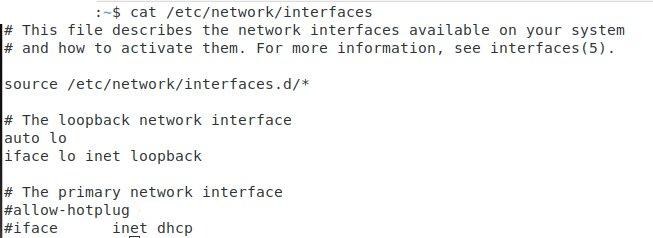

After installing Cinnamon as an office environment you risk having a hiccup with the network manager who indicates that the Wired on / off switch is unmanaged.
Nothing simpler, it happens by commenting on arguments in the conf interfaces file.
We open a terminal window as root then insert the lines below:
nano /etc/network/interfaces
Then comment on these 2 lines as follows:
#allow-hotplug ****
#iface **** inet dhcp
Adapt the asterisks according to the name of your network interface, if you do not know the name of this one:
ip link show
Choice 2 will tell you
And finally restart the service:
/etc/init.d/network-manager restart
And here is the incident resolved smile
#allow-hotplug ****
Where did you get those two lines? My interfaces file only has the entry for the loopback device. Did you set up the network manually during the install?
#allow-hotplug ****
Nope I did not do anything, it was thus by default before having commented on the 2 lines described, here a screenshot:

#9 2020-04-15 16:28:03
Posts: 2,993
Re: [HowTo] Fix Wired unmanaged under Cinnanom 3.8
OK, thanks. That's odd. I did two cinnamon installs yesterday from the desktop iso - one with a mirror and one without a mirror. I didn't get those lines in either case.
